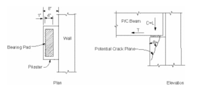

Look at PCA Notes on ACI 318-11 example 14.2: shear-friction design (inclined shear plane).
This is the exact failure you have.

@TME - thanks for the reference. Your exactly right. Given the loads though, it just seems odd that it's happening. But then again, I haven't gone through the calcs.

Use these lateral loads applied to the wall parallel to the beam. Then look at the issue similar to an anchor (bearing plate anchor) subject to the applied load as a shear force parallel to the beam. Or look at it as shown in ACI notes when evaluating the reinforcment design.
