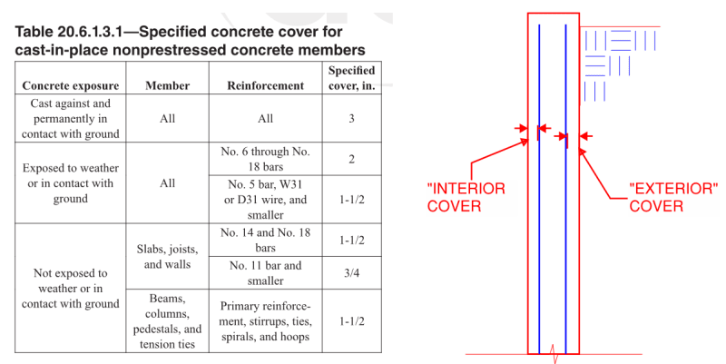

Based on the concrete cover specified by code, can you have different covers for the exterior versus interior bars of a wall based on their different exposures? Or do they both have to have the same cover based on being part of the same "member" that is exposed to the elements or in contact with the ground?
