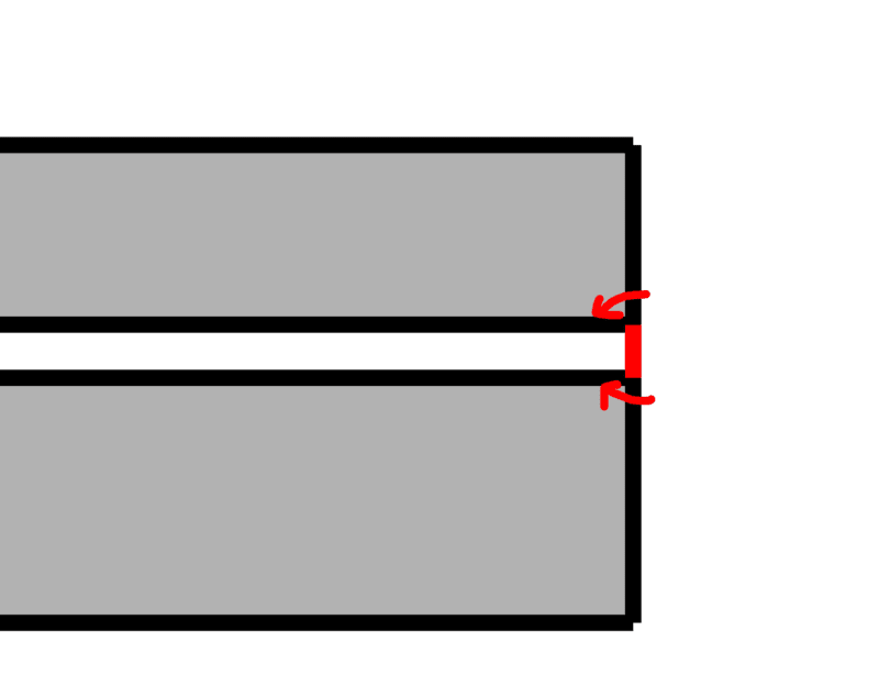

Is anyone aware of any exceptions for the ends of the bars, say at the end of a beam or the edge of a slab? Is the concrete cover requirement the same on the ends of the bar, or can a lesser amount of cover be justified at the bar ends?
Minimum required cover applies to any part of the bar.

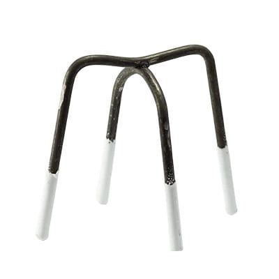

This is the principle behind plastic tipped metal bar chairs:

@Tomfh the issue that I see with epoxy coating bar ends is that you still have close to zero cover around the bar. You could likely epoxy coat an area of the slab as well to mitigate that? Personally I spec repair mortar to suspended slab edges.
Yes I agree. By coating the bar ends, I am referring to a length of bar, like the bar chair pic above. Alternatively you would need to coat a wider area around the bar as you suggest, in order to increase the effective cover to the steel.

Metal bar chairs with plastic tips are basically formwork, they hold the rebar before the concrete hardens, corrosion at the tip is concealed by the plastic tip, not prevented. This is not analogous to coating the ends of structural rebar.

When I mentioned that coating the ends of the rebar can inhibit corrosion, I was referring to the same concept as using metal bar chairs with plastic-coated ends.
Why wouldn’t it also work at bar ends? What the actual difference.
Not to be abrasive, but try reading what I wrote.
