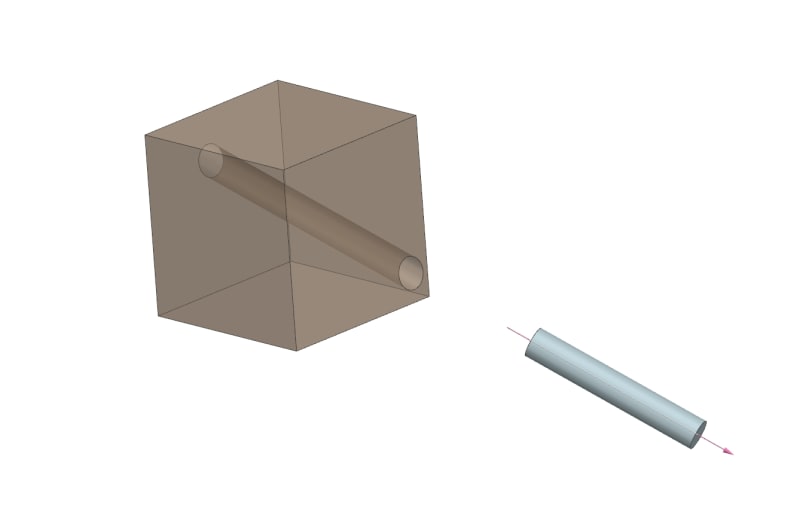

Hi, is there a way to align in a concentric way one body to another inside of a part not an assembly.
What I want to align to is not in the common xyz direction it is angled.
Once aligned how do I move the part in the direction of the angled axis that I just aligned to, meaning distance.
Thanks,Buddy.

Yes I know about move or ctrl T.If I have a simple 3" block and one hole drilled into the block at some very strange angle and I import a part that is a shaft the same size as the hole, then how can I align the shaft to the hole in a concentric way, not in an assembly.

Would direct editing features like "make coaxial" and "linear dimension" work?
NX 12.0.1.7 Windows 10
I made a block and drilled a hole then imported the shaft part and aligned with synchronous make coaxial then created an axis.
How to move shaft in direction of axis?

Do you need an exact position?
If not, you can use synchronous modeling>move face linear and drag into position.
If you do, create a datum plane perpendicular to the hole at the desired position and use move face linear. Use measure distance to get the distance from the cylinder face to the datum plane for your move distance.

If you've got dumb bodies, transform would do what you're after.
See attached video.

Nice,I thought there was a way to make those moves.
