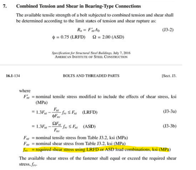

Hey guys,
I am trying to calculate and check the design strength of plate bolt connection. So to do this i am following J3-2 of the AISC code book. The part that i got stock and hopping someone here can explain to me is how to calculate the Frv in J3-3B equation. I have 4.5kip shear force and 3.15kip tension action on 5/8" bolts (0.226in^2 area).
