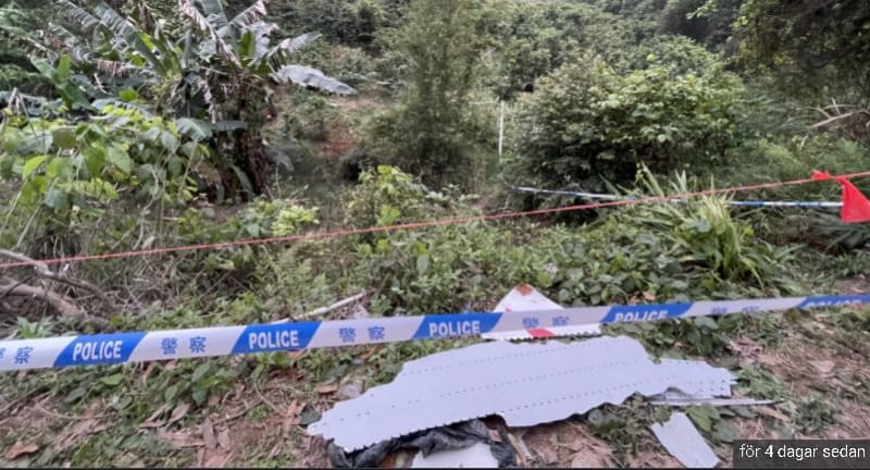

It was a long white strip ... about 1.3 metres long and 10cm wide ... 1cm thick and had a few dozen hexagonal screws or rivets on it. There was a small area of blue paint at the centre of the strip,
Could this be a strip off the rudder?

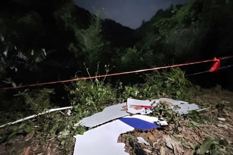

Yes but the debris photo looks like it is more then just a strip of about 1.3 metres long and 10cm wide ... 1cm thick though.
So is that the actual photo?
There is also this photo??

Looks very suspiciously like a wing, elevator or other flight surface. This is not going to be good. So did that cause the descent, or was it the result of the high velocity. Since it was found at the end of the dive's ground track, it may be an indirect result.

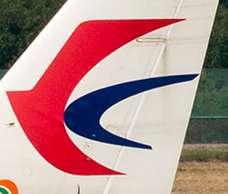

It’s the trailing edge of the winglet. Same swooshes as on the tail. But at the right scale.
Looked like a lot of rivets for a winglet, but I can't say I've ever looked that closely at them either. May be the view is too far away, but they look pretty slick.
H & V stabilizers, elevators and rudder. Only semi-close up I can find. I'll go with one of these for now.

I think it's off the tail cone. Under the Apu.
Loads of rivets in that area due the shape.
