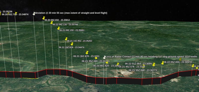

The trailing edge of the right winglet was found 12km away, but nearly all other major parts - engines, wings, tail, rudder and stabiliser were all apparently found in the crater.
Nothing apparently untoward in terms of the crew, cargo or any pre flight faults. No weather issues reported.
I guess it's wait for the data from the recorders time, so hopefully it gives us all some answers.
New data points added to flight path - white push pins
I would expect a report with factual data from the flight recorders is released relative soon.
