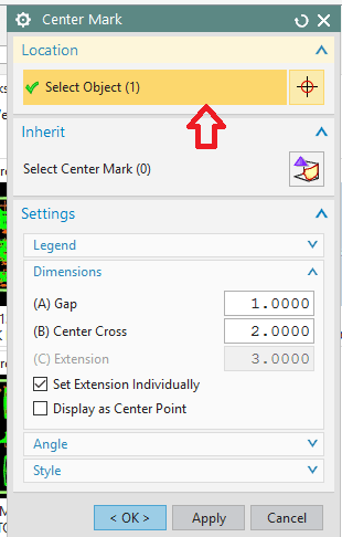

* Make sure your drawing views are up to date
* When in the centerline menu, make sure the proper thing is highlighted

What kind of centerline symbol are you describing - we may need to know exactly. Is it a Center Mark (cross shape - like Jerry shows above) or a linear Centerline? Is it a 2D Centerline or is it a 3D Centerline (which is based off cylindrical faces of solids)? Is it an automatic centerline (created when you place a view)?
What steps are you taking when you try to reassociate this Utility Symbol? I just have to double click and if a black X appears anywhere in the dialog next to the Select Object area, click it to remove previous selections and reselect the new objects to which the symbol will be associated. Some symbols might require you to right click on the spheres/blocks in the graphics window to click Remove to clear out the old objects (like if you've placed a Center Mark (center cross) on 2 entities, sometimes NX gets lost and needs those cleared out.

it is for center mark. When you have unassociated center mark, double clicking it, and trying to re-associate to new circular cutout edge does not make it associate..
I have to re create it..

The short answer to your question about "why" is that when you remove components or bodies (including sheets and/or solids) you're removing to what the Center Mark is associated (edges, etc.). Now, on to fixing the Center Marks....bear with me here - I'm trying to be as descriptive as possible so you follow these steps. They need to followed exactly.
I've tested this out in NX11 and didn't have any issues. I would think this would be the same in NX12. First, you need to understand that there is a center point for each Center Mark (or Center Marks if you're picking arcs that are in a linear pattern). It will be that small square that appears in the center of the Center Mark. When you activate a Center Mark (double click on it) that is alive (associated to geometry) you can MB3 (right click) on that center point (box) and click Remove and reassociate to another arc center. You can also activate a living Center Mark and it should highlight the object to which it is associated; you can press Shift + MB1 to deselect the object and pick another to reassociate. When you replace one component with another, you lose that center point's associativity and the Center Mark is "dead". To reassociate to a new center point (of an object), you can do 1 of 2 things.
[ol 1][li]Double click on the unassociated Center Mark and then right click on the center point and choose Remove and then select the new object (or center point).[/li]
OR
[li]Double click on the unassociated Center Mark (which brings up the Center Mark dialog) and go over the the top of the dialog where it says Selected Objects and there should be a box to the right with a black X in it. Click that X to remove ALL old unassociated center points. Now pick the new center points. If you have more than 1 center point for the Center Mark, the black X removes whatever is missing but KEEPS the points that are still there (if they are on the SAME body). Once you change out solids/bodies/components, the Center Mark will not retain any center points.[/li][/ol]
I hope this works in NX12 - that's exactly how it's done in NX11. Video attached showing a live Center Mark being associated to other objects and then a dead one being reassociated to new objects. Done in 2D for simplicity but the same applies for marks associated to solids/sheets.
