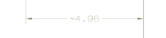

I am currently using NX2312. In both sketcher and drafting (though this is the most important in the drafting application I suppose), when dimensioning two objects that have decimal places beyond the dimension limit, the approximate (double tilde) symbol automatically appears before the dimension. Is there a way to remove this symbol? In my case, I am dimensioning objects with very abnormal positioning, so it is not desirable to increase the number of decimal places to try to eliminate this symbol, and in this case the number of decimal places could be increased to 6 and the approximate symbol would not disappear.
Example image shown below:
If there is a way to disable this behavior in the customer defaults I would be interested in those settings as well. Thanks!

In Drafting, are these symbols still visible if you de-activate the sketch ?
Toost is correct, once you finish the sketch in the drafting, the symbol should go away. I dislike how these dimensions behave so differently in the drafting application vs the older sketcher. But they should go away once you finish the sketch and pan around.
In NX Modeling, in modeling sketcher, the approximate dimension definitely goes away once the sketch is exited. So PMI dimensions at the top level will not show that symbol, which is great.
However, in NX Drafting, the same does not appear to be true. I tried finishing a drafting sketch, panning around, refreshing/updating the sketch, and even making another sketch the active sketch. The approximate dimension is still shown.
After you finish your sketch, grab the dimension and move it a bit.
That seemed to do it! Thanks! This is a very weird mechanic in the software.
That is a nice way of saying it, ha. I am glad this worked. I do not think they have this as robust as it should be. Have a good weekend!
