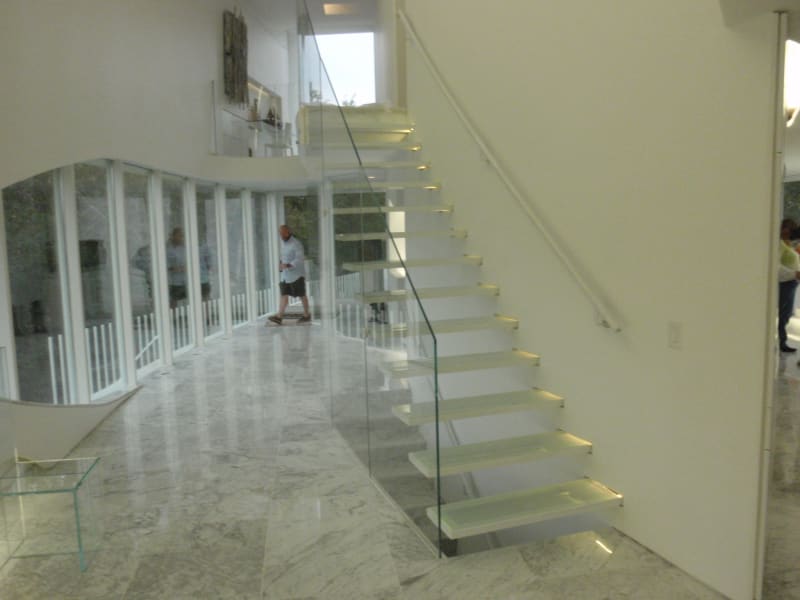

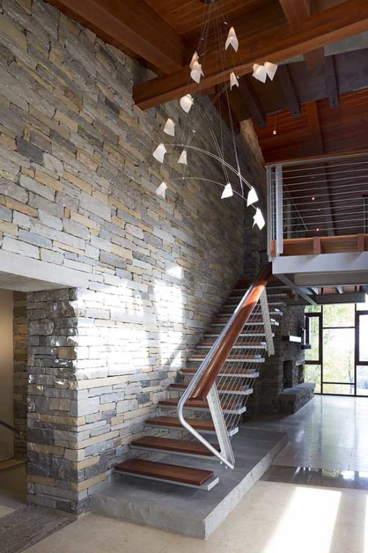

Yes totally agree. We've done a couple of them - free end cantilevered treads - both required either a large (hidden) steel tube in the wall or a solid cast concrete wall with embedded steel to allow for the cantilevers.
JAE - Great pics
To answer the OP's question.... the "spread" of the bolts that you show in your sketch does not seem adequate to produce a load on the anchors that will (likely) be within the capacity of the anchorage.
Not sure how much "hiding" you can do but... I'm wondering if there will be a wall covering. Maybe that will allow you to bury something more substantial within the wall.
Also, the bending load on the wall is a big unknown (as suggested by the replies).
