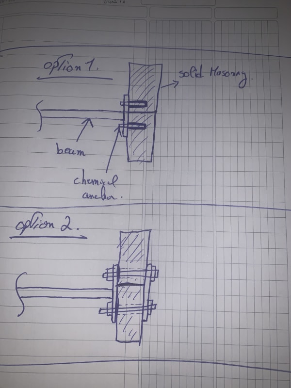

Hello all,
As the subject says, i am in one of those situations.
There is an existing solid masonry wall that need to support a one floor cantilevered staircase structure.
For the fixing of the cantilevered treads structure to the wall i am thinking of two options.
Option 1) using chemical anchors with anchoring adhesive but all these chemical anchor suppliers recommend one bolt per masonry cell and thats an issue since the anchor bolts spacings are going to be less than a masonry cell.
Option 2) using a sandwich connection between the treads beams and the other side of the masonry wall; basically welding steel rods on a plate, inserting it from the opposite side of the wall and fastening the structure on it from staircase side.
I think option 2 can be better than option 1, but i need guidance, advices, and even other options but taking into consideration that it’s an existing solid masonry wall and it is not under construction.

Sketch would be helpful. First thing I'm thinking about is the flexural moment coming from a cantilevered staircase. Will the CMU be able to support it? Maybe some reinforcement to the CMU is required, like grouting the cells. But maybe your arrangement doesn't induce any moment except a little eccentricity, in which case it might work.
Option 1:
You might be able to get epoxy anchors to work. The manufacturer guides should have a reduced capacity for when they're close together. And if you can't, consider using a WT or something to spread the anchors out. I can send a sketch of this if you want, but I'd need to see your sketch first to see if I have the right idea about what you're doing.
Option 2:
I'm not sure what option 2 is. I don't think you'd necessarily need to weld the bolts to a plate. You can just use thru-bolts, which would avoid some shop welding. The only concern I'd have is bending in the bolt itself. The inherent eccentricity of the connection means one side will be in compression (bearing on the CMU face or brick wythe) and the other would be in tension (on the other side). I've never analyzed something like this; I'm mostly posting this musing to see if others have the same thought.
In this case, bearing stress has to be checked because it will be higher than the epoxy anchor case. Also, I'm not sure how you can make the connection tight. Meaning the hole through the masonry will be larger than the bolt itself. It won't be a slip-critical connection in masonry, so there will be a bit of slippage. But once the load is set, if there's no load reversal (loads will always be gravity), then that's not a concern.
For these reasons, I tend to go with Option 1 because it's simpler, with less things to think about.

I draw a sketch by hand.
More than bolt in a masonry cell i inevitable in option one because the beam is too small compared to the masonry size, its 400x150x200mm solid masonry. The stair tread is composed of light hollow section trusses.
Anyways here is the sketch.

What if i did option 2 but i filled the hole after drilling with anchoring adhesive prior to fastening each step?

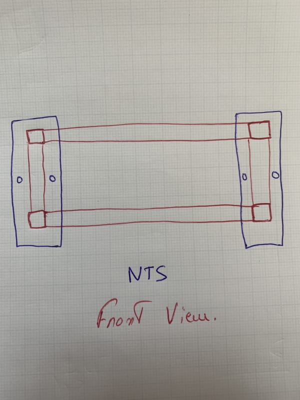

I can do that,
Pinned connection sound like a good idea,
I think i can achieve a pinned connection by using two anchor bolts in the direction of the stair.
Below is a new sketch.
Any comments?
Detailing is a hobby,

Below is a new sketch. "At right is a new sketch".
Any comments? I don't understand it.
Detailing is a hobby, Keep at it!
I suggest a ledger fastened to the wall at perhaps 1200mm centers (measured horizontally) and a stringer of similar depth at the free end of the treads. The stringer should be supported by posts, one at each end of the stair. A handrail (or perhaps a plexiglass wall) is required at the free end to prevent folks falling off the end of the treads.
