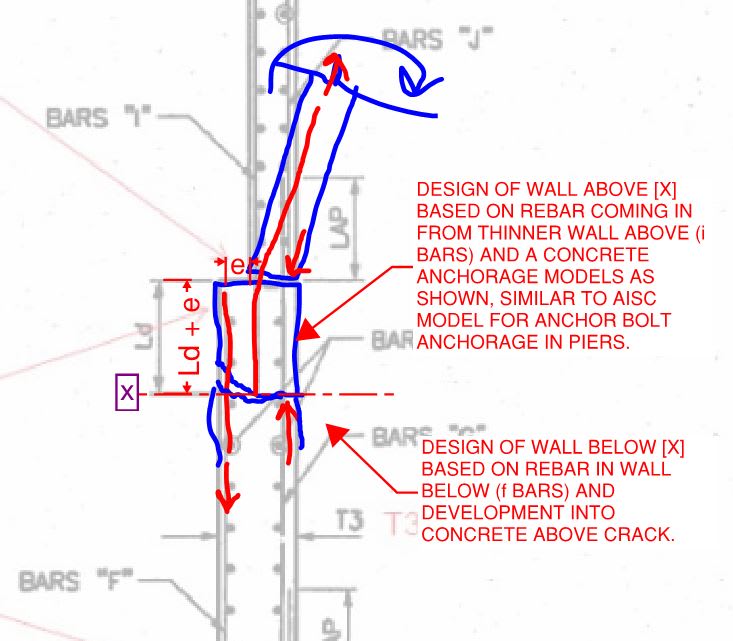

So... back to your ideas about the original detailing being adequate if designed correctly. I'd like to critique your proposal but, first, I need to understand it. Presently, I'm not sure that I do. It's always difficult to clearly express these kind of concepts with prose alone.
As I see it, things work like this with there being two, mostly binary choices:
1) You can use reinforced concrete theory to transfer the moments from the upper wall segments to the lower. This encompasses most of the suggestions and STM models suggested in this thread. Or;
2) You can use anchorage theory to transfer the moments from the upper segments to the lower. This basically amounts to appendix D / concrete in tension stuff.
If I understand your solution correctly, it is #2 above and would reflect the model shown below. Is that correct?
I will always prefer path #1 to path #2 purely on the basis of perceived reliability. RC principles trump anchorage principles always and forever with respect to reliability as far as I'm concerned. But, then, that's just my personal preference and not a code requirement etc. So I'm happy to weigh the merits of your proposal once I've got a solid grasp on it.

Firstly, let's be clear: I have not suggested that anyone use the AISC model. In the post where I mentioned that model, I was trying to envision what Aesur's been describing and the AISC model seemed quite similar to me. That was a guess at what Aesur might be thinking, not a recommendation from me. Now that I look at it, however, I see that my sketch conflates two separate ideas however. I see Aesur's proposal as either:
1) A purely anchorage solution wherein the presence of the [F-bars] is immaterial to that part of the connection or;
2) Truly the AISC model which I would consider to be a poor-man's / half-assed lap splice.
For #1, I'd like to replace my previous sketch with the one shown below. It's fictionalized but a much better representation of the concept.

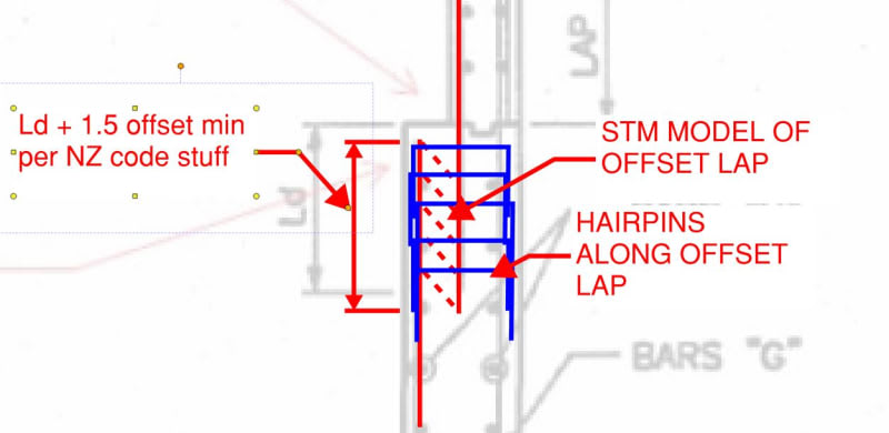

What if you extended i bars Ld_i below "X". Meaning the total embedment for 'i' bars is Ld_i + Ld_f.
No matter how long you make an offset lap splice, it's still an offset lap splice, right? Some thoughts on that:
3) Intuitively, one would think that, at some length of offset lap splice, you'd be okay.
4) Just because you lap from Denver to Cleveland, that doesn't mean that observers in the Cleveland suburbs will be seeing any bar tension in the off-loading bar. Elastic theory makes it clear that most of the lapping action takes place early on in the lap. This runs counter to #3 and one can envision a progressive unzipping of the lap regardless of how long it is.

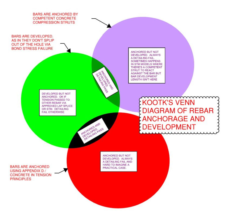

I like to think of this mathematically as shown below. Perhaps other will find that helpful.

To my knowledge, ACI does not say anything about this. Nor do most textbooks. Ideally, I'd like to see an ACI clause something like this:
1.0 This document is primarily concerned with reinforced concrete design which requires that all rebar tensions be anchored by concrete struts or approved lap splices to adjacent rebar. If you're doing something else, that's not reinforced concrete design. See chapter whaterver for voodoo anchorage procedures utilizing concrete in tension.
My guess is that ACI doesn't say this because they take it as being so fundamental and obvious that it doesn't actually need to be said. Clearly, they would be wrong about that as it causes endless confusion among concrete designers (me included back around the turn of millennium).

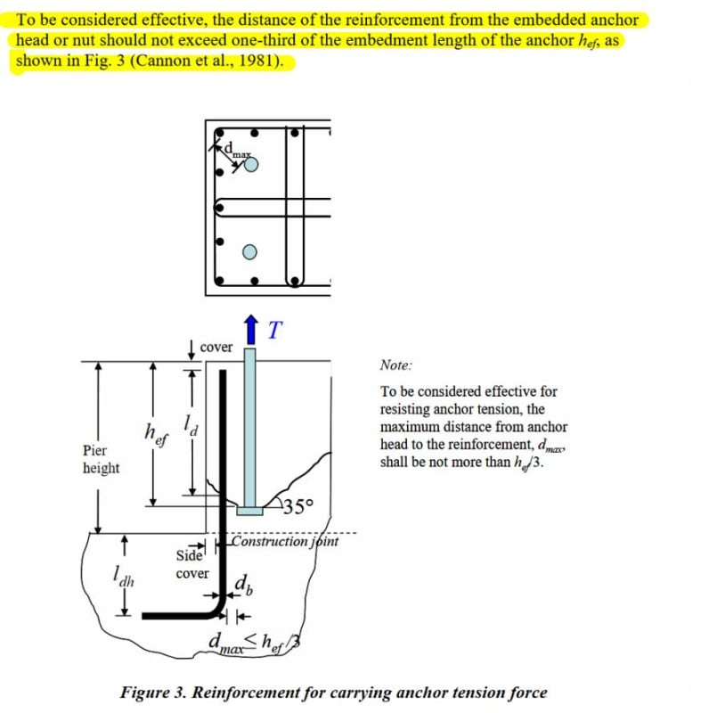

In the past, for high tension loads, I have used the anchoring to concrete section of ACI (D for 318-11) for justifying embedment into the top of drilled piers where the rebar was fully developed on both sides of the expected concrete failure plane (the 1 to 1 1/2 slope).
For this situation either add hairpins with extended embedments or slope the backface rebar to eliminate the offsets (preferred).
Here's a figure from a very famous anchor reinforcement paper. I believe this is applicable to our current situation and I would be inclined not to provide hairpins as long as these requirements are met:

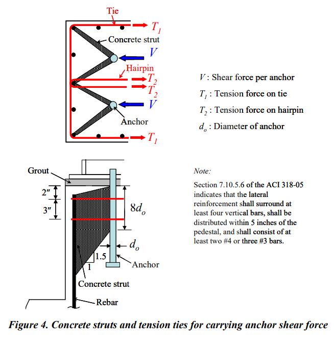

The procedures in that document also require ties which function similarly to the hairpins in the retaining wall. The document treats the ties from a shear transfer perspective but, regardless, they're assumed to be in play. I'm not sure that Widanto meant for his tension solution to apply in the absence of the ties. That said, I believe that he does count on untied bars in the tension calcs.
Interestingly, as asides:
1) This is the AISC model that I mentioned, applied to concrete, pretty much verbatim.
2) Widanto's actually remiss in suggesting that Ldh is sufficient into the footing without additional checks.
I will say, however, that even in the absence of ties or hairpins, I like the situation a lot better with the upper bars un-deformed and terminating in a headed anchorage.

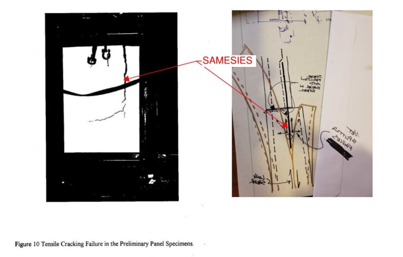

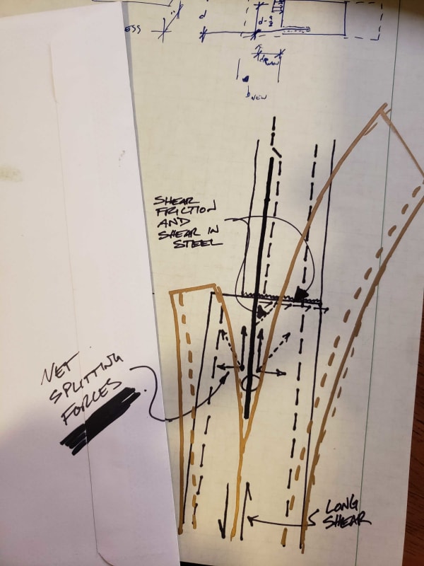

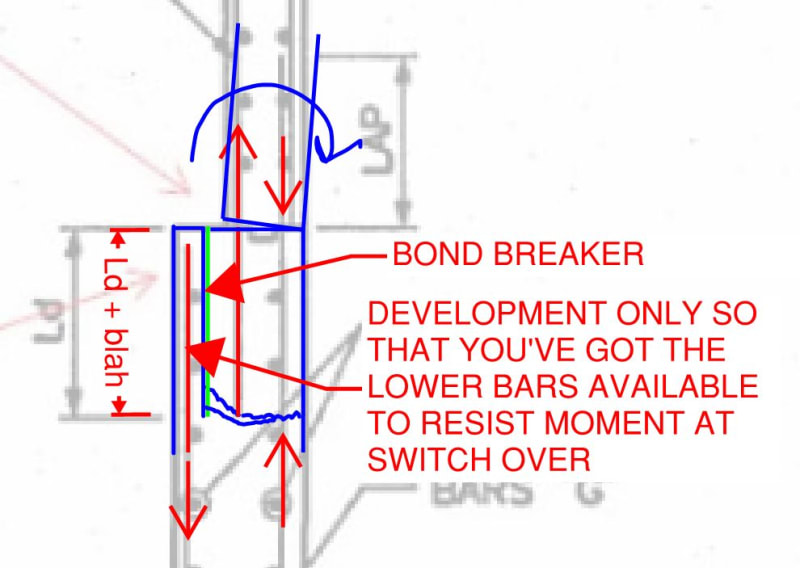

I've gotta say that I've also walked over to the Koot camp. I'll take a stab at it.
The failure that keeps coming into my head is the wall effectively 'splitting' in half where the 'i' bars develop into the middle stem. Think of the forces in the wall at that interface. You've got a bunch of horizontal (earth) shear pulling the outside face away from the backfilled face, via shear friction and shear in the bars. Youve got tension in your 'i' bars. Tension in the 'i' bars induces a splitting force into the section between bars 'f' and 'g', resisted by tension between the two 'lamella', composed of the rebar mats+half the wall thickness of concrete. Think of the - probably negligible - longitudinal shear between the front and back face of the wall (shearflow between compression and tension side). I think that was partially discussed in the other development length threads. Without some sort of tie, I'm buying into the 'i' bars splitting the top of the middle stem in half, reducing bond strength to zero.
What I imagine is similar to Koot's bond breaker example, but the split occurring at the 'i' bar. See my crude sketch below. Exaggerated perhaps, but a plausible result, no?

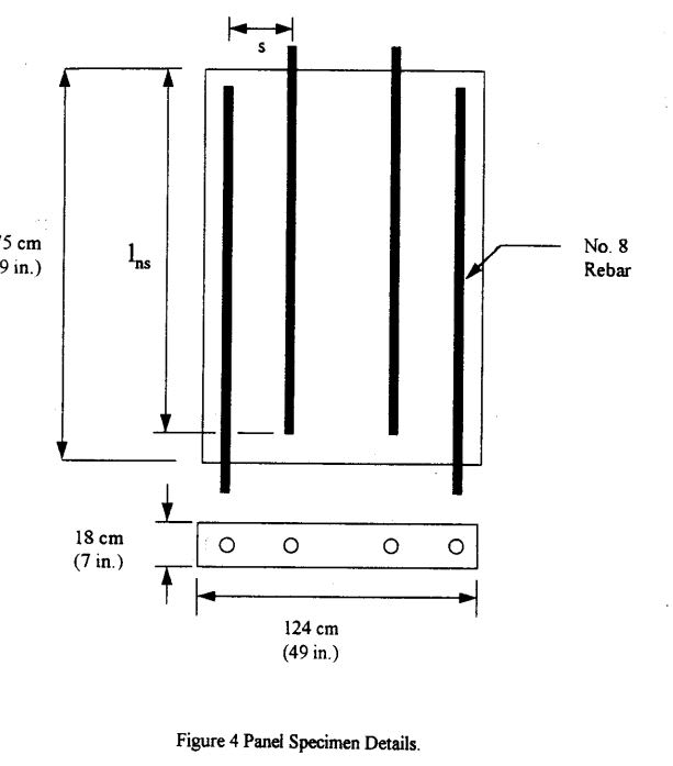

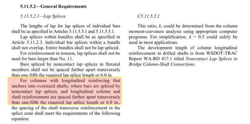

I was looking for something else in the AASHTO spec. this morning, when I ran across something that may be related to this subject. Section 5.10.8.4.2a has provisions for lap splices, non-contact lap splices, and requirements for longitudinal columns reinforcement that "anchors into oversized [drilled] shafts".
For non-contact lap splices, the distance between bars cannot exceed 1/5 of the lap splice length or 6".
For column steel in oversized drilled shafts (exceeding the 1/5 lap or 6") it has a fairly involved equation to calculate the required transverse reinforcement around the perimeter of the drilled shaft in the splice zone.
The commentary includes this statement:
The development length of column longitudinal reinforcement in drilled shafts is from WSDOT-TRAC Report WA-RD 417.1 titled Noncontact Lap Splices in Bridge Column-Shaft Connections. Eq. 5.10.8.4.2a-1 is based upon a strut-and-tie analogy of the noncontact splice with an assumed strut angle of 45 degrees.
I almost posted the very same sketch when I was trying to describe the unzipping phenomenon on very long laps. The plausibility of it really is the issue in my mind. The function performed by the hairpins in the sketch below could also, plausibly, be performed by the concrete acting in through thickness tension. I've investigated this a bit numerically in the past with Mohr's circle combination with shear and flexural tension stresses. Numerically, it's not terrible and I suspect that this mechanism is what makes the poorly detailed version work out in the wild. That, and BS soil loads. A tricky part of that analysis is estimating how much wall length can be engaged this way for each bar. Most to all of the wall length I suspect.
I see this as a research gap as much as anything. The badly detailed connection surely has some capacity; somebody just needs to bring it into the lab and find out what it is and how to work it so that reliability is on par with reinforced concrete principles.

Based on the Washington State DOT paper linked by KootK above, it seems safe to design with:
non-contact lap length = ld + e or ld + e + [top cover] when measured from the top of wall (e is the offset distance between longitudinal bars). Per code, ld shall be the larger of the development lengths for different bar diameters.
shear reinforcement must be provided at a spacing s = Av Fyv / (As Fy) x (ld + e) over the full development length and must be developed into the compression flange. This assumes compression struts form at a 45 degree slope and the shear confining reinforcement is equivalent in strength to the tension reinforcement being developed. Simply providing a longer development length without shear rebar would run the risk of initiating a crack between vertical bars when they first go into yielding followed by that crack propagating/unzipping as the yielding continues until premature failure

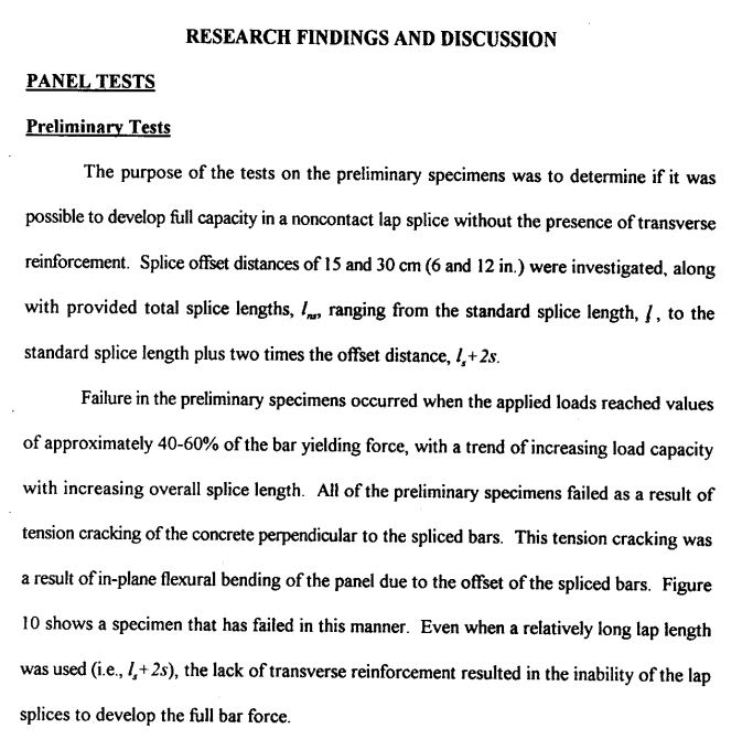

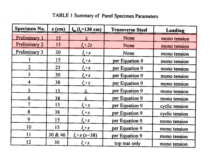

After reading BridgeSmith's latest, I decided to dig a little deeper on the whole, allowable 6" offset thing. Here's what I've got, tabled for consideration.
1) As I mentioned above, I've always considered the 6" option to apply only where the offset is in the plane of the member (wall, slab, etc). I've considered it to be not applicable where the offset is out of the the plane of the member. To my knowledge, ACI says nothing about this which kind of implies no limitation in this regard.
2) If OP's original sketch were detailed with 6" offset, this would mean that condition would be acceptable. I think that's nuts.
3) The AASHTO provisions that BridgeSmith cited are shown below. Based on the context, it's hard to see how that doesn't imply that 6" offsets out of plane are acceptable.
4) The DOT study tested 6" offests without transverse reinforcing and found that they failed pretty much in line with the sketch that dold worked up. And at as little as 40% of the yield strength of the bars. #8 @ 7" is a little dense but still.
5) The DOT study mentions the allowable 6" offset but then says nothing about the fact that their own testing of the condition would suggest that it would be an unsuitable provision for out of plane offset scenarios. Their wrap-up recommendation is to have transverse reinforcement for all offset splices but, given the ramifications of this, you'd think that they's specifically say something to the tune of: for the love of all that is wholly, do not to the 6" offset thing out of plane without transverse bars!
What gives?
