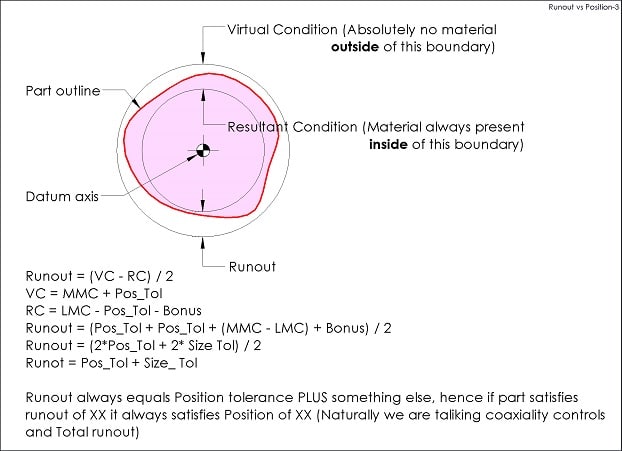

Here is my take on how "surface interpretations" of position and runout may look like:

Still, I stand by my opinion that even if surface does not take the precedence, it is not legit to compare "surface vs axis" results.
I wonder how many people in the world when doing a radial tolerance stack-up that includes a runout tolerance, WOULD NOT assume that the maximum offset between axis of a feature controlled with that runout and the datum axis equals half of the runout tolerance? It is a rhetorical question, because this is what people would for sure do and this is what all stack-up books also tell us to do. And this is exactly where surface control (runout) gets translated into axis control.
Pylfrm's illustration geometrically (hence mathematically) shows this assumption doesn't always have to be true.

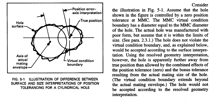

1) I'm not sure exactly what ASME means by "the tolerance in terms of the axis may not be exactly equivalent to the tolerance in terms of the surface" - could you provide some insight into this? In my mind the two cannot be truly "equivalent" since its a bit like comparing apples and oranges, one evaluates UAME axis deviations and one evaluates surface deviations. The way it reads in my mind is "if the axis interpretation falls outside the specified tolerance (fails for axis deviation) but the surface interpretation does not violate the virtual condition (passes for surface deviation), then surface interpretation takes precedence (the part passes inspection)". Is this a valid reading of the standard (ie: pass vs. fail for each)?
2) If you agree with my interpretation (1) above, then what would you say if the theoretical example in question (by pylfrm) was in regards to a feature which had a position tolerance applied of 10 but a total runout tolerance of 5? Would you agree that the measured position error is 9.544 as shown since it does not fail/fall outside of the specified position tolerance? If not, what do you believe would be the measured position error?
3) Taking a more practical approach to whether the surface interpretation makes sense for RFS, imagine a feature which looks like the one in Fig 7-6. First imagine that it is a feature with a tolerance applied at MMC and it is a clearance/through hole for a bolt - one can see how even though the axis of the UAME falls outside the specified tolerance, it still results in a perfectly usable part since the virtual condition is not violated and clearance to the bolt will still be provided in assembly. If the same feature has a tolerance applied at RFS because the intent is to mate in some way which would interact similarly to the UAME (ie: centering action of an expanding pin/mandrel or press fit) would not the deviation of the UAME axis be of critical importance over the surface interpretation?
I guess they meant something like this:
This may (partially) answer your other questions

Unfortunately that doesn't really help me understand much more than Y14.5 already lays out. Maybe I'm missing something, I know I might not have as tight a grasp on the concepts as others here.
To further clarify what I was asking in my question (1), it seemed to me that by what is meant by "equivalent" is really whether the interpretations are in agreement, as in the feature would pass by both interpretations or fail by both interpretations. This is because I do not understand how the magnitude of a surface deviation could be directly compared to the magnitude of an axis deviation and then considered mathematically equivalent. It is only when the two interpretations are no longer in agreement, and the feature passes by one and fails by another that the surface interpretation can be considered to take precedence.
I would say they are NEVER in agreement, except the simplest cases of perfect form and orientation.
But in this case there wouldn't be difference between position and runout anyway.

Wasn't the picture I provided compare surface deviation to axis deviation? If they can be so far away even in one example, they are not "equivalent" - that's your math.
