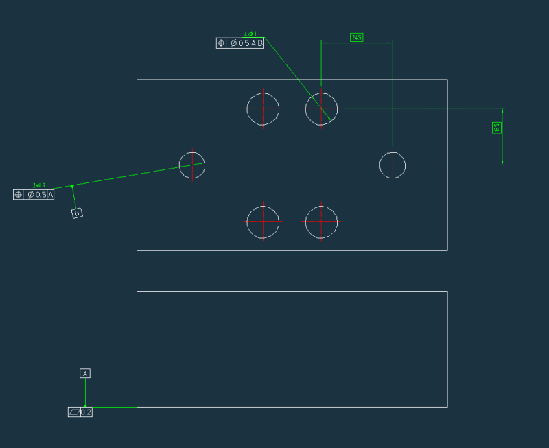

Hello all,
I have been trying to find an answer to this one and maybe you could give me your 2 cents. If I want to control the position of one hole in relation to another do you considered that I still need the 3 datums? Below I made a simplified drawing of what I consider to be a correct position tolerance for the hole in the top rigth. Am I till controlling all degrees of freedom? A is not in the picture but consider it as the plane defined by one of the faces perpendicular to the hole axis.
Thanks in advance.

Hello all again,
First thanks a lot for the discussion and ideas! I think by trying to simplify the part and its function (also can't share full design obviouslly) maybe left too much open. The assembly condition is more of less like Burunduk refers. The two 9 mm holes have pins presse in and the bushing is actually on the mating part (I then have an assembly drawing which also controlas the position of the pressd pins). The other hole (11 mm), which in the actual part is more than one, have connectors attached that mate with connectors on the counter part. That's that reason why it's important that the 11 mmm holes are dependent on the 9 mm ones. First there is a pre-alignment, achieved by the 9 mm holes (with the pressed pins) and then the connectors attached to the 11 mm holes meet with connectors on the counter part.
Going back to what jassco and Burunduk proposed I think it's what makes sense here. I had somehow achieved that in my original spec but a bit different (close to 1st option from jassco, each 9 mm hole as one datum). I like more pattern since it show better the assebmly condition which for me should be the driving force behind the spec.
Below (again very simplified compared to the actual part) is what I think represent the proposal. (I'm not using MMC since there are pressed pins in those holes).
Again thanks a lot, 1st time posting but have been reading a lot of discussions here :)
Ah, outer shape is also important to control but I also agree with jassco that profiles can be used there in realtion to the hole features.
Thanks again!
PtoMonty,
An important question we forgot to ask you is: what standard do you work to?
The suggestions and discussion so far were based on the implicit assumption that the drawing would follow ASME Y14.5, but if you work to ISO, there should be some modifications to the symbology to convey the same meaning, as patterns in ISO are specified differently.
Also, since the 2 locating holes are for press-fit pins, you are correct that MMB is not appropriate, but it may also be a bit more complicated to use it as a pattern.
How accurate will the "pre-alignment," as you say, by the press-fit pins be?
Often, for accurate location without over-constraining, one pin fits into a hole, and that mating sets the location, while the other pin mates to a slot that provides clocking (locks rotation). If that is the case, then the hole for the locating pin should be the secondary datum reference, and the one for the pin that mates with the slot should be the tertiary datum reference for positioning the 11 mm holes for connectors and the periphery surfaces.

Replying to both there are floating features that prevent an over-constrained situation.
PtoMonty,
Since there are floating components in the assembly, would it be correct to say that one press-fit pin will locate and the other one will clock similarly to the hole-then-slot mating method I described, or is there no such division of roles?
Burunduk,
Rigth now there is no such division of roles. This I have thought about in the past but we are working with existing parts which are not possible to change now (we would lose compatability with older versions). Also I think we have enough margin (the bushing is slightly larger then the pin to account for deviations) that both have the aligning function (and fight each other a bit for sure).
Hi, PtoMonty:
You can't press 2 pins into two holes (dia. 9mm) with the position tolerances of dia. 0.5mm wrt to datum feature A unless the plate is made from soft materials, like lumber.

The main difference is the need to use the CZ modifier to force a simultaneous relationship between features rather than the default that ASME 14.5 has.
I think the original question has been answered - no, you do not always need three datum feature references (or whatever term the ISO group came up with) to locate features. Multiple features in a group can be used as a single reference to control orientation and location of the other holes.
I think ISO uses "B-B" to indicate that multiple holes are used as a single feature, for example.
Check your copy of the standard to be sure.

Hello both,
Yes the original question has been asnwered :) Only way to produce enough information is to produce all information which I can't since it's sensitive business information. I ahve simplified it to get an answer to my "basic" question. What prompted me to ask the question is that I thought my spec was controlling all degrees of freedom but my supplier came back with position measurement that only took into account perpendicularity to A and one single axis (horizontal let's say). So as far as I saw their interpretation was incorrect. With the info you all have provided I will try to strenght the spec (and maybe simplify it).
In ISO like you said I should probably have two datums and refence them as A-A, or B-B (which I was already doing in the first place).
3DDave, Please disregard the dimensions and tolerance values. They were picked random just to have numbers there. I don't fully understand what you mean with you can press them. They are individual pins. You press one, then the other. THen the part (with two pins), mates with the counterpart that has two bushings. Anyway thanks also for your input!
Another important difference between the ISO and ASME standards, in the context of what you need, is that in ISO in order to apply a simultaneous requirement between two or more geometric tolerances of position or profile, it’s not enough for them to reference the same datums in the same order and with the same material boundary modifiers, like in ASME. In ISO simultaneous requirements must be explicitly specified. This is done by writing SIM next to each tolerance indicator.
In your case, this is relevant to the position of the holes and the all-around profile you will specify for the peripheral surfaces, to relate the 11 mm holes with the periphery of the part.
