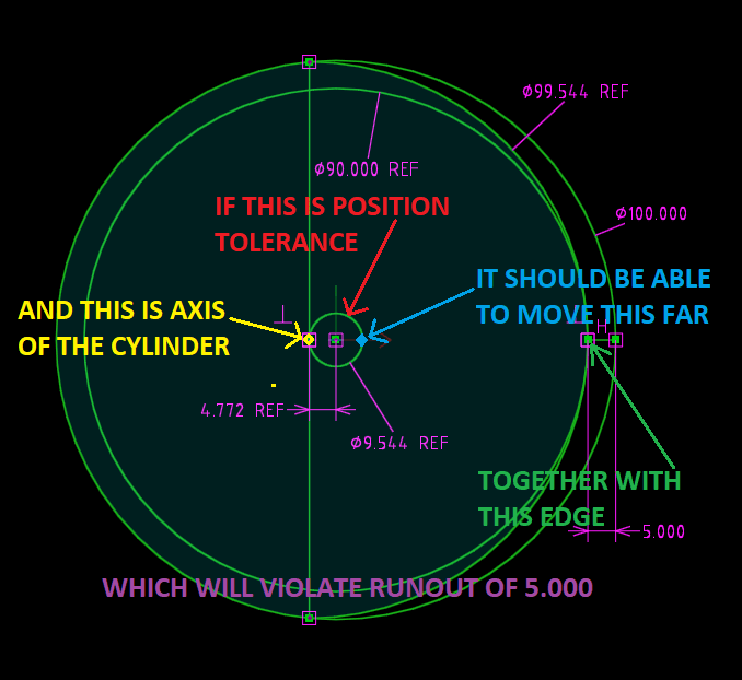

In any case can Position Tolerance and Run-Out can be applied together to a Feature of Size or plane surface.
I know both are location control doesnot make sense if applied to same feature, but just want to make sure about this thing.

No. The virtual condition boundary is not violated unless the actual value is larger than the tolerance value.

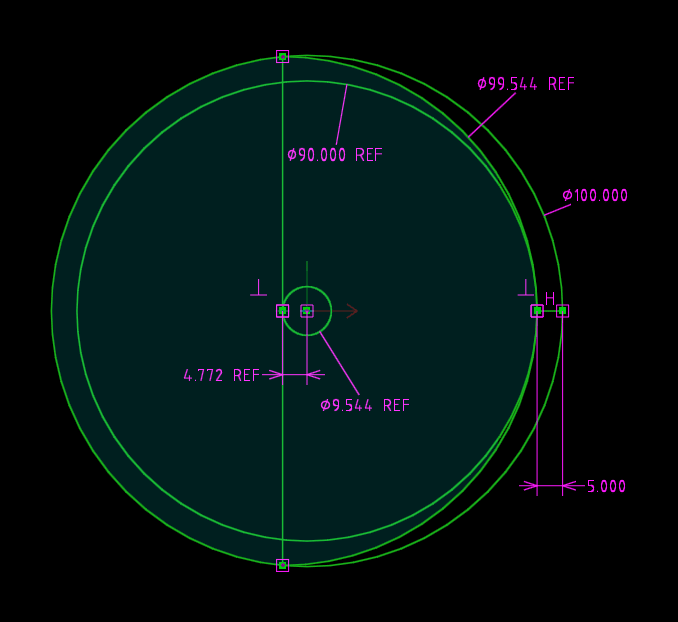

Interference to what, the inner/outer boundary if the UAME were shifted to true position? Does it even tell you that?
I meant interference between the actual part and an imaginary boundary of UAME size, but located at true position. The actual value is two times the greatest radial interference. Admittedly, this is basically just a restatement of the definition. It's probably not an amazing insight into functional or practical meaning, but it was the best I could come up with.
For [url ]this example[/url] we get an actual value of 9.544 with the axis interpretation, and 0.456 with the surface interpretation. Imagine we modify the part by shifting the feature 4.772 to the right. This makes the UAME axis coincident with the true position axis and brings the position actual value down to zero for both interpretations. How much better is the part in a practical sense though? To me, an improvement of 0.456 seems somewhat more reasonable than 9.544. The runout changes from 5.000 to 4.544, and I think this paints a better picture: There was a slight improvement, but most of the error remains.
