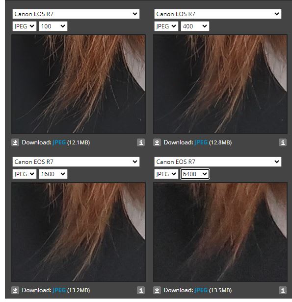

The link you provided earlier is pretty good for judging how far you can take ISO:
I'm doing a bit of testing. The stabilizers are fantastic. I'm able to handhold shots, which blows my mind and everything I know about photography. But I need to use ISO 800 to expose it correctly with decent light, good grip (braced to the body), and breathing technique, which is basically ideal conditions. I wouldn't expect to always have that amount of daylight or employees to be able to achieve that. So it's tripods for now, and I'll do a bit of thinking about how to train employees to do it correctly. And maybe everything will work better on a day with even more sunlight.
Yeah, that link was instrumental in helping me choose a camera. People said a lot of good things about the latest rival cameras (Sony, Fuji) but based on that website, they just don't hold up as well as the R7. It also made me decide that I basically always need ISO 100 to 200 for all my shooting, though I'll try a few different things in practice and see how it goes.
