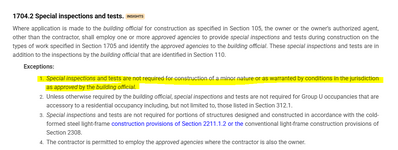

I don't think specifying steel on a house should trigger IBC special inspection procedures - if the EOR is inspecting it. The IBC has an exception clause for simple construction as well.
That's my point. That exception, as you quoted, says "as approved by the building official." Should that approval be given positively or passively? In other words, should they have to say "this counts as minor, no special inspections required" or is it sufficient to just get a building permit issued without a statement and/or schedule of special inspections included in the application? The more I think about it, the more I lean toward the former.

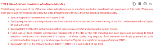

Not sure about the vanilla IRC, but our version here in Virginia (the Virginia Residential Code) indicates in the Admin Chapter that indicates special inspection requirements in the IBC are to be considered valid provisions of the the code. So at least here I think it does say that special inspections, where triggered by the IBC on elements outside the scope of the prescriptive elements of the IRC, are required on an IRC structure. Georgia and other states may be different.
"..... OR as warranted by conditions in the jurisdiction as approved by the building official." To me this leaves it up to the EOR and the latter is acceptable.
Curious to see the exact verbiage of this. IBC SI can be considered? Or must be considered? Georgia does not have this provision.
It still says as approved by the building official. Meaning the final decision is not with the engineer, but with the building official. Maybe you have some rock star plan review staff that doesn't miss anything, but I routinely get calls from contractors asking for help because "our plans got approved but now the inspector is saying something is wrong, and when we asked plan review they said 'oh yea, sorry, we missed that - you have to do it the way the inspector is telling you'". So I'm not on board with letting the plan reviewers waive special inspections by negation (or lack thereof).
From the 2021 Virginia Residential Code (2018 IRC, edited) as available on iccsafe.org:
