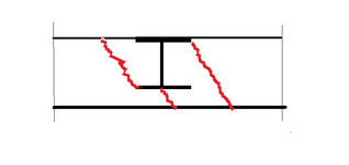

Has anyone here ever analyzed a steel I-Beam cast in concrete for breakout? Some ideas I have are to add nelson studs to the web of the beam, or add weldable rebar to the sides/bottom, but I have never actually seen any calcs or procedures for this. I've got some pretty high tensile loads to resolve. Just wondering if there are some "typical" details or simple details that have been developped that I could look into.
Top of concrete is top of top flange, equipment is then welded to the top flange.
The OP should give more info for the loading and provide a sketch . If it is pure moment , ( no lateral load with lever arm..) and the couple is applied to the top flange at extreme points , imo , the use of welded shear studs could be considered to improve the strength .
With limited info . provided , breakout should be shear failure at opposite sides rather than pull out. I have provided a simple sketch for breakout scenario.

The slab will be much thicker than the scale you've shown, thick enough to preclude any shear failure. I don't have a say in WF vs embed plate, it is being supplied by the supplier as part of the machine assembly.

People are talking about the breakout, but I've done lots of weird steel industrial junk and the part that's flashing bells for me is the wide flange. How are they getting load into it and how is it spreading load around? How is the item above anchored to it and how often? This is something that feels like it should be stiffened to hell and back unless the loads are basically negligable
There's all sorts of plate bending and torsion stuff here that is really not compatible with concrete breakout mechanisms.
1) How are they getting load into it and where do they think it's going. Their plan needs to match your assumptions for some of this stuff. like, if you think this is a bearing on one side with tension down the web to the bottom situation, then they need to have a load path to get there too. The load path when you're loading in this direction with bolts or welds tying in is pretty fiddly and you going off in one direction when they've detailed something incompatible ends up being a problem.
2) This wide flange isn't going to span torsion down the length of itself, so if these are discrete connection points to the superstructure them it's only going to provide anchorage into the concrete really locally to those points.
3) The bearing/breakout mechanism is what came to mind as an option with me as well, but I'd be really wary of parts of it without stiffeners because flange bending is going to come into play. Your bearing for the breakout cone might just be a couple of flange thicknesses wide, for instance
4) The lack of bar continuity ends up being weird from a confinement standpoint. I don't really like the tension mechanism without it, honestly. Draw out what that concrete breakout looks like if it's only happening on the tension side and it's only bearing a few tf past the web. You've got this little 12" thick piece of concrete being asked to do an awful lot and don't even have the redundancy of continuous bars through it to provide a bit of friction if that crack opens up. It doesn't feel great to meIt also sounds like this is potentially dynamic, which raises crack control concerns local to the rail that would need some bar continuity
5) If you're doing the bearing / tension couple thing, you probably want some vertical bars adjacent to the beam to drag the tension back down into your load carrying slab. If you have continuous bearing bars through your beam then I'd need to think about this a bit more, but if your slab below is the thing with spanning capacity then you need to get uplift down there unless the weight in the breakout cone is enough to fully resolve the moment.
Can you give an idea about the magnitude of loads? It makes a pretty big difference. I'd also be screaming for information on the detailing of the rail because what it looks like may answer a lot of questions above how it's supposed to be working.
