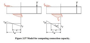

Has anyone here ever analyzed a steel I-Beam cast in concrete for breakout? Some ideas I have are to add nelson studs to the web of the beam, or add weldable rebar to the sides/bottom, but I have never actually seen any calcs or procedures for this. I've got some pretty high tensile loads to resolve. Just wondering if there are some "typical" details or simple details that have been developped that I could look into.
Top of concrete is top of top flange, equipment is then welded to the top flange.

The top of beam runs parallel to top of slab, almost like a rail would. Their equipment connects to my beam with a moment load, and that moment load needs to transfer into the slab below. The moment is an overturning moment, which would presumably rotate about the bottom flange toe.
So like this?
Are you allowed to have stiffeners etc in the beam?
Yes like that. I assume I could do stiffeners, but I believe that would be up to the supplier to specify. I'm wondering if nelson studs off the bottom instead of the sides are just better for this.

Something like this would be my Cadillac solution if stiffeners were viable.

I believe it is more or less continuous, at least that is how the manufacturer presents it and notes as such. Are the stiffeners explicetly required, or if the top flange was stiff enough to not cantilever up would this be okay? I'm assuming that the flange rotating clockwise pushing into the concrete does not require the stiffeners, and that the stiffeners are only required to hold the flange down.
I do like the idea of releasing the tension how you have shown. Where does your compression plane wind up? Bottom flange of beam?
When I take away the stiffeners, I tend to feel as though doing nothing at all might be almost as good as anything else that you might do. And this kind of suggests the breakout mechanism that you mentioned .
Enough stiffness in the beam plate elements obviates the need for stiffeners. That said, I'm not sure that much stiffness would be practical. This ties into my question about reversibility. And, to a lesser extent, I would have the same concern if the load were significantly varying even if it did not reverse. I'd not be too excited about the top flange developing a gap with the concrete over time, as I would anticipate.
In my conception of it, the primary purpose of the stiffeners is to make the whole beam act as a unit torsionally, without significant cross sectional distortion. This allows one to spread out the tension and compression portions of the resisting mechanisms plausibly, without having to sweat a bunch of weird prying mechanisms that no one can evaluate accurately.
In the slab. No matter how you handle this, the beam torque becomes slab flexure somehow.

I feel as though it would have been something like this on a set of hand drawn, "pre-anchorage" drawings from the 70's. And for modest loads, I'm sure that it would be fine. Our ancestors were rather clever in spite of, or perhaps because of, the unavailability of accessible FEM.
The connection story told below barely even uses the beam below the top flange for torque resistance.
Which takes us back to the statement below. Basically, you're delivering the load to an embed plate that is the top flange.
I feel as though the "typical" would be to weld the beam to a cast in embed plate rather than embedding the beam.
