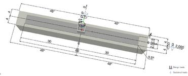

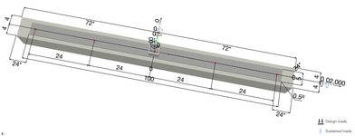

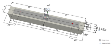

Per Hilti Profis analysis, when providing groups of anchors loaded in the same scenario, the load capacity is also 2,000 lb regardless of the number of anchors.
Single anchor fails from concrete edge breakout at 2,000 lb.
3-anchor group fails from concrete edge breakout at 2,000 lb.
5-anchor group fails from concrete edge breakout at 2,000 lb.
I’m not sure of the right way to interpret this information. For instance, if you had a single angle and single plate using this attachment, you’d develop the 2,000 lb reaction. If 2 ft away, you had another anchor on a separate plate, I believe you’d achieve another 2,000 lb reaction. However, when you put these anchors on the same plate, you get limited to a single breakout capacity based on a single anchor (regardless of the number of anchors). This is due to the limiting geometry perpendicular to the edge, all described through Avc and Avco per ACI 17.7.2.

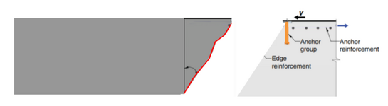

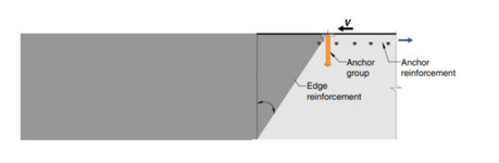

So from all of this, the critical edge distance is 16 in per ACI, while the actual edge distance is 60 in. So how does this breakout actually look or occur?
Is it like this? If so, I have two follow-up questions:
1) If the entire section fails through the depth of the member like this, why then does it change when the edge distance is set to infinity versus 60 in or 200 in for that matter?
2) Would it be the longitudinal bars that provide the required shear friction to prevent this breakout plan from slipping past itself? (I know I have post-installed anchors, but I'm still interested in how the supplemental reinforcing works.)
Is it like this? If so, I have one follow-up question:
1) To me, only the stirrups would prevent this breakout plane. Even so, I don't know how these stirrups would actually develop bc there isn't enough width for the stirrup to develop as a hooked bar. (I know I have post-installed anchors, but I'm still interested in how the supplemental reinforcing works.)

In your case, the longitudinal bars will intercept the edge breakout crack, as shown in post #3 by CDLD.
So, what you're saying, is if the longitudinal bar DID NOT EXIST the failure of the beam shown in the OP, with an long edge distance would cause the beam to break out like this?
Take this same scenario and rotate it so the load was pushing down to a footing. It still breaks out like this?
