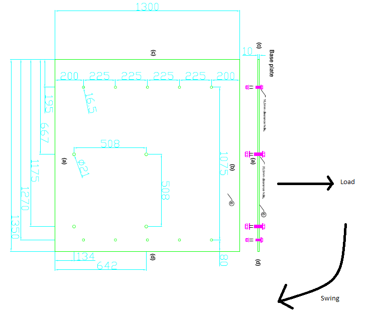

I'm currently trying to find a equation/formula to help show the applied for acting on a bolt and making sure its within the yield strength of the bolt.
From the image you have a davit with a load on the end, this will then transfers the force onto the bolts.
Currently i have used the shear formula and tensile to get the individual loading as followed
e.g.
Load : 6000N
Bolt : 10mm
Yield : 400MPa
Shear (single shear)
tress = Load / A..............A = 3.14 x 5^2 = 78.5398mm^2............6000 / 78.5389 = 76.3943N/mm^2 (MPa))
As there are 4 bolts holding it down then i devied the stress by the number of bolts for get the individual stress on each bolt..............76.3943 / 4 = 19.233575 MPa
400 / 19.233575 = 20.79 factor of safety (FoS)
Tensile (same formula as single shear)
Stress = Load / A..............A = 3.14 x 5^2 = 78.5398mm^2............6000 / 78.5389 = 76.3943N/mm^2 (MPa)
400 / 19.233575 = 20.79 (FoS)
As the forces is not acting on the axis or in a shear formation but at 45Deg, do i need to have the force applied in each direct at 50%?
Also in not sure how to combine there's to get the overall stress on the bolt.
Im also aware that the load will course the davit to rotate in some wear between the base and end of the davit arm
If anyone can point me in the right direction it would be appreciated

Please see the layout of the plate and retrospect to the load and swing
Hi DJCoutts
How thick is the plate on the actual davit base as opposed to the one in your last post?
Also what distance have you got between the hole centres and the edge of the plate on the actual davit plate?
I think the number and size of bolts your using are okay for the lifting of the 6000N load but I want to do the calculation a slightly different way and tats why I need the dimensions.

Here are the following for the davit base
Base size : 584.2mm square
Hole positions : 508mm square
Hole size: 20.574mm
just want to make sure that is was not miss in my earlier post, the davit it self is a off the shelf item which we have bought, so making sure that the plate we are bolting to is the right thickness will take the load with reasonable stress limits.

I think the bolts are okay given the safety factor you're using, my calculations assuming the davit plate tips at the front edge of the base plate which puts all four bolts in tension albeit that the front two bolts see only a small proportion of the load when the lift is purely vertical.
I reckon the bolts will see about 13-15kN when maximum load is vertically lifted but I haven't done any calc's when the ship rolls and the lift is no longer vertical.

How thick is welded base flange that comes with the purchased davit/crane?
In one sketch it looks about twice as thick as the 10 mm thick base plate you are providing.
In another it is shown as about 1/3 as thick as the 10 mm base plate.
Several of the four davit flange bolts are over are 470 mm (almost 20 inches ) away from the nearest anchor bolt.
I think, when lifting 6000 N (1350 lbs) the 10 mm base plate is going to bow upward alarmingly if it is secured by the 10 bolts along the edges as shown.
See the OP's post dated 1st March, he states the actual load to be lifted is 600N, so at 6000N there is a SF of ten
