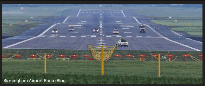

I had a quick look on GE.
Birmingham tarmac is 3000m, but piano keys to keys is only 2300 whets stn or PIK is 2759. Runway is 15/33 which is quite strange for the UK where many are much more east west so maybe that was included in their assessment. Definitely more room to run off the end a bit.

Piano keys to piano doesn't really give the full picture there are multiple rules about what you can and can't use as your distances for landing and take-off and they can be significantly different depending on the objects off either end of the runway. Touch down marker to end of the runway is a good enough approximation.
But I would be surprised if PIK is worse off than BHX. Most of PIK's life it has been a NATO heavy Nuke bomber designated runway. It is utterly colossal and there is nothing much round it only thing that will beat it are the eastern Germany runways but they are all concrete slab. Its also one of these microclimate airports where the local wx system is usually much better than the rest of the UK. BHX is a pain in the the bum sporty approach slippery in the last third up and down wavy runway, As the ATP tried to do you have to try and hit the top of the first hill other wise you end up floating down the back side. Anyway Just because I would think twice about taking a sick aircraft their is only my personal opinion and mostly dictated by having over 1000 landings there. I have similar at MAN and apart from the pissing rain it would be my preferred option.

BHX looks like an interesting runway alright....
