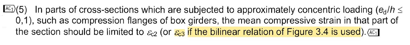

This is from "Reinforced concrete design to eurocodes" by prab bhat, page 371 and 372.
It has mentioned the it's for My/ (hb^2) = 2.
But I don't know how to reproduce with that ratio kept constant. So, I tried to create it with making the alpha and beta values at a constant ratio of 0.8 (beta = 0.8 alpha). Then I produced a chart.
Since I didn't reproduce the exact chart in the book, now I have another problem. I have got no reference chart to compare my chart with. Can anyone kindly help me find out if my chart is correct for the column dimensions and data I provided.
Are there any free software/ excel sheet to enter the column details mentioned below and compare it with my chart?
I'm concerned that my chart may not be correct as I don't see the part the book's chart have I have shown in the green rectangle below, when I produce my chart. I understand it cannot be the same chart, but if my chart is correct that "nose" like curve should also be in my chart isn't it.

A couple of points regarding the reduction in maximum strain:
The reduction is not just for pure compression. With increasing axial load and reducing bending moment, the full strain at the compression face is maintained until the NA reaches the bottom of the section. From that point the strain at (approximately) mid-height is maintained constant, at 0.00175 or 0.002, and the strain at the compression face reduces.
On the other hand, under pure compression the stress distribution is exactly the same for the parabolic-rectangular and the uniform stress block. They both have uniform strain and stress across the full section, so it makes no sense to me to require a reduced strain for the uniform stress block. My suggested procedure is:
1) Find the section capacity with the NA at the base of the section and the full compressive strain at the top face.
2) Find the axial load for uniform stress across the full section with a strain of 0.002 (or as required for higher strength concrete)
3) Use linear interpolation to find the maximum axial load with the specified minimum load eccentricity, and section capacity for any intermediate axial loads.
Also note that for uniform compression the 0.9 reduction factor for triangular sections is not required, because again the parabolic-rectangular and the full uniform stress block have exactly the same stress distribution in this case.

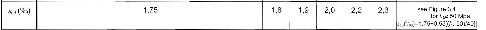

Method 1:
I
f we just cap the strain at 0.00175 (or 0.002) when the column enters pure-compression
Method 2: using 0.00175 (or 0.002) instead of 0.0035
when the column enters pure-compression, we use 0.00175 (or 0.002)
strain = distance to r/f from NA * (0.00175/depth of NA)
I don't understand why that does not comply to Eurocode? I feel like that's also compliant (although the curve may not be smooth at the transition, I don't need a beautiful curve).
But it's also safe isn't it? I don't get why we need to complicate by adapting a completely new method of calculation.

I'm not sure what you are doing with your calculation of N1, but N1 is exactly as it was in the original calculation. The strain at the compression face is 0.0035, so why would anything change?
The "pure compression" case is uniform compression across the full section. Between those two extremes there is a smooth transition, where using the rectangular stress block numbers:
- The compression face strain reduces smoothly from 0.0035 to 0.00175
- The mid height strain stays constant at 0.00175
- The bottom face strain increases smoothly from 0 to 0.00175
If you must, you can calculate those strains and then calculate the forces and moments as before, but the results will be very close to a straight line.
In addition, using the rectangular stress block when the NA is outside the section has two problems:
1) When the base of the stress block reaches the base of the section (i.e. NA at D/0.8), the top strain is still very close to 0.0035 and the full concrete section is at maximum stress, but using the parabolic-rectangular stress block there would be a significant portion of the concrete with significantly less than maximum stress, so that case is unconservative.
2) Under uniform compression the strain is reduced to 0.00175, but the concrete stress distribution is the same as for the parabolic stress block, so that case is unnecessarily conservative.
So doing the linear interpolation is not only much simpler, it is also closer to the results you would get with a parabolic-rectangular stress block.

In pure compression, for steel, I applied 0.00175 (Eurocode says to use it if using simplified stress block) cap, and again capped the stress at fyd. It makes a difference as I see, because it caps the strain at 0.00175 and then check for fyd later, we take minimum of the two values. So as I see it does matter whether to use 0.00175 or 0.002.
For me, It's ok to have a straight line. And since Eurocode simplified model follows simplicity, I understand at some point it just uses capped values, which may result in straight like lines, that's fine for me.
All I need to check, if my chart is Eurocode compliant and so, that means if it's in the safe limits. At this moment I really don't want to have a parabolic level extreme refinement. I just need to follow the simplified method and produce the conservative and safe diagram.

The code says:
"If the width of the compression zone decreases in the direction of the extreme compression fibre, the
value eta fcd should be reduced by 10%."
So it isn't applicable to rectangular sections when the NA is parallel to the compression face (or to T sections), but it definitely is applicable to rectangular sections with a rotated NA. It is also applicable to circular sections. In both cases only when a rectangular stress block is used and the NA is inside the concrete section.

The code says:

Further, since you said that the strain limit 0.002 is your interpretation of the Eurocode, I'm curious what made you choose 0.002 as the strain limit as the Eurocode shows to use 0.00175. (As I used bilinear 0.8x etc model to simplify the compressed area). Is there any logical reason to use 0.002?

Regarding the strain limit, this makes no difference until the NA is outside the bottom of the section, where the axial load exceeds 2970 kN. Up to that point all the sections have a maximum strain of 0.0035, reducing to 0 at the NA. The only remaining calculated load has uniform strain across the full section. Because the strain is uniform, I have used the parabolic-rectangular stress block for that case, with a constant strain of 0.002, which complies with the code requirements. I have used linear interpolation between the two final points, which seems like a reasonable assumption to me.
We are not analysing a compression flange of a box girder, so the code quote above does not apply to our calculations, but it isn't clear to me just when it should be applied. If anyone else familiar with the use of Eurocode 2 has any comments on that, I would be interested to hear them.

The code says "where ed/h < 0.1". That is not the NA position, it is the eccentricity of the axial load. If the axial load has an eccentricity of less than 0.1h, the NA will be outside the section. If the eccentricity is zero, the NA is at infinity.

You are right. After going through it, I figured out I have applied the 0.00175 reduction too early, even before it go beyond pure compression. I rectified it.
Do you get the same diagram as below? for the run 1?
I believe the sudden drop at the end is expected as it caps the strain at 0.00175 once it enters the pure compression.
However, I have another doubt, how can the axial force still increase beyond the pure compression, after consuming all the cross-sectional concrete area as compressive force and for the steel we have 0.00175 strain cap. I feel like it should be a drop and then a horizontal line once it enters pure compression. Or could it be an another error?
