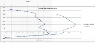

Your new results are still inconsistent with the calculation for 158 kN axial load, and my spreadsheet results.
The screenshots below show interaction diagrams from my spreadsheet (blue line with no markers) overlaid on your graphs (blue line with markers) and the calculated values for 158 kN axial load (red point).
@IDS
Thank you for the diagram and the comparison provided.
I found out where the fault is. I believe now they are matching.
Full data in the spread sheet were also updated.

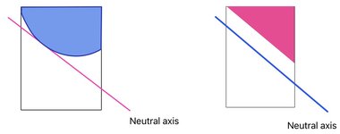

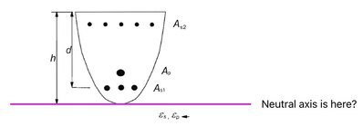

I noticed in the Eurocode, the parabola is shown as it goes all the way to the bottom surface. So, does the code assumes in that situation the neutral axis is in bottom location? I believe they are showing a uniaxial scenario, but still I need to understand where the neutral axis is at in their diagram.
So, the following parabolic stress block and the neutral axis location is correct or wrong in our biaxial scenario?
I mean I basically want to confirm the fact that the location where parabola ends will be taken as the neutral axis location. It should right, because it's where compression and tension becomes zero, so we are considering it as the NA, right?

I have another question until I apply the strain limit at the full compression and until I prepare the detailed calculation for a point where there is a significant difference in results.

It looks like you have been misled by the Fig. 6.1. The parabolic shape has nothing to do with the stress block, it is just showing the concrete outline for a random non-rectangular section. If you drew stress contours on your left-hand cross section all the lines would be parallel to the Neutral Axis, and the compressive stress region would extend to the NA over the full extent. It is the relationship of stress to strain that is parabolic-rectangular
Regarding the limit on the maximum strain, and the shape of the interaction diagram for high axial load, I will check the Eurocode provisions for axial load limit and get back to you on that one.

Thank you for the response and for the clarification.
Yes I was mistaken it for a stress block inside a rectangular concrete section.
Now I understand it's just a random section of a concrete element. For a moment I was questioning my self the very basic understanding I gained about the compression block ending at the neutral axis.

I agree with the results of your calculations above but note the result includes the 0.9 reduction factor for the triangular section, but this wasn't shown in the calculation.
I have updated your latest interaction diagrams with my My results, showing excellent agreement up to the balance load, but significant differences for high axial loads (see below). The horizontal steps in the results at 2000 kN axial load don't look right, especially for Mx. Do you know what is causing that?
Regarding the application of the strain reduction when the NA is outside the concrete section, I will get back to you on that but I want I want to check my spreadsheets are handling this correctly first.
@IDS
Thank you for the diagram comparison and the comments.
In the previous post, the 0.9 reduction factor was applied to the the calculation "axial (Nc) = 22.667 N/mm2 * 9163.08 mm2 = 186926.83 / 1000 = 186.93 kN", but I mistakenly have not typed it. But the answer has already accounted for the 0.9 reduction factor. So it should have been "axial (Nc) = 0.9 * 22.667 N/mm2 * 9163.08 mm2 = 186926.83 / 1000 = 186.93 kN".
I will go through it and will try to see what causes the reduction above the 2000 kN.
However, I noticed, if I didn't apply the 0.00175 strain at pure compression (the Clause 6.1), it aligns more with your diagram. Only the points above 2700 kN, is largely incorrect, I believe.
Did you apply the reduction at pure compression in your chart?
Pls check if it's even required as we're already accounting for eccentricity even before the development of diagram (at analysis phase), I believe we don't even need to apply the reduction factor for pure compression at this phase, as we're not even expecting the column to be in pure compression as per the Eurocode.
A couple of points regarding the reduction in maximum strain:
The reduction is not just for pure compression. With increasing axial load and reducing bending moment, the full strain at the compression face is maintained until the NA reaches the bottom of the section. From that point the strain at (approximately) mid-height is maintained constant, at 0.00175 or 0.002, and the strain at the compression face reduces.
On the other hand, under pure compression the stress distribution is exactly the same for the parabolic-rectangular and the uniform stress block. They both have uniform strain and stress across the full section, so it makes no sense to me to require a reduced strain for the uniform stress block. My suggested procedure is:
1) Find the section capacity with the NA at the base of the section and the full compressive strain at the top face.
2) Find the axial load for uniform stress across the full section with a strain of 0.002 (or as required for higher strength concrete)
3) Use linear interpolation to find the maximum axial load with the specified minimum load eccentricity, and section capacity for any intermediate axial loads.
Also note that for uniform compression the 0.9 reduction factor for triangular sections is not required, because again the parabolic-rectangular and the full uniform stress block have exactly the same stress distribution in this case.
