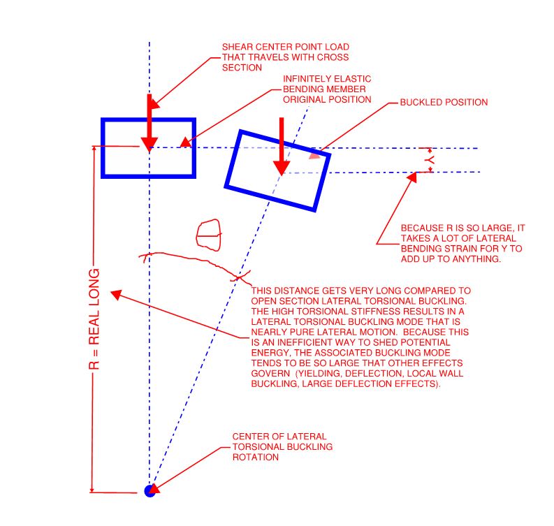

Eurocode says that a steel pipe item (part of a structure) is not affected by a bending+torsion instability (i.e. when the torsion stiffness is bigger than the bending stiffness ??). I am looking of literature discussing and explaining such a statement. Thanks
In the strictest sense, there is really no such thing as a destabilizing force as a thing considered separately from a destabilizing perturbation (displacement in our context). The destabilizing effect is that of any combination of:
1) A perturbation displacement and;
2) A force which would do positive work when the perturbation is exacerbated.
In this respect:
3) the axial compression load on an Euler column is the "destabilizing load" when a lateral perturbation is considered (external load moves in direction of load).
4) the applied external load in my sketch is the "destabilizing load" when a lateral torsional perturbation is considered (external load moves in direction of load).
5) an axial tension load on a column is a "stabilizing load" when a lateral perturbation is considered (external load does negative work as the ends draw closer together).
An internal force action really cannot be destabilizing, in the strictest sense, precisely because it does no external work. Rather, it is a manifestation of the member strain required to do the external work.
Interestingly, by extension of the same logic, this too would be mathematically possible, if practically ridonkulous. No doubt many would consider this to a constitute a point against my reasoning. Presently, I do not.
This is somewhat similar to an interesting phenomenon that I noticed when tinkering with buckling analysis using the software package Mastan last fall. If there is any potential for instability, the eigenvalue analysis will find it. It just might be at an applied load ratio (ALR) of 47,000, that's all.
I would play with lateral torsional beam buckling (LTB) and, once all of the expected modes of LTB were restrained, it would start producing "buckling" modes that looked like pure lateral translation (no motion component parallel to the the applied load). They never were pure lateral translation though. Rather, there was always a slight torsional component even if it was imperceptible to the eye.

Agreed, that's precisely what I was speaking to below. While non-shear center loading is surely more common in the real world, I thought it most instructive to restrict myself to shear center loading because it eliminates some potentially confusing complexity and makes for an apples to apples comparison to the classical wide flange LTB derivation. That said, I'd be thrilled to discuss the finer points of non-shear center loaded LTB with any interested parties.

4) For any real world tube of such great length, it will likely be prudent to consider the destabilizing effect of loading above the shear center rather than at the shear center. There really are not many common ways to load a tube through the shear center and loads located at other locations may well result in:
a) Pure torsional buckling if it is the case that the tube would stay put and the load source would translate laterally or;
b) Something like constrained axis lateral torsional buckling if it is the case that the load would stay put and the tube were free to translate laterally.

The torsion is due to a lateral offset between the load and the shear centre, which increases as the pipe twists.
How is that not Lateral Torsional Buckling?
