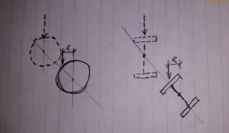

Which one below will be kicked into higher energy state after the additional T = P*e?

I think the pipe. What's the point?
That's the LTB phenomenon graphically (not exact) explained. Yes, the pipe, n Now you can think a mathematical explanation for it. I am running out of bullets, please help yourself.
Omg, I understand that a I section is subjected to LTB and, in general, not a pipe. Thank you for the pictures. I asked for a mathematical analysis, starting from the equations of a beam and searching a condition where the total potential energy is maximum (if it is possible to find that condition, if it is not possible I'd like a mathematical explanation for that). If I asked for it, maybe I can't find it alone.

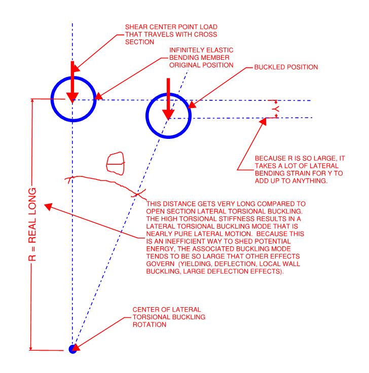

In my opinion, you'll not find such a mathematical explanation because it is in fact possible to laterally torsionally buckle an infinitely elastic, shear center loaded circular hollow section. See the mechanism below which is similar to retired13's work. When we say that these members cannot laterally torsionally buckle, what we really mean is that their lateral torsional buckling resistance is so high that it's of no practical interest to us as designers because other failure modes will kick in long before lateral torsional buckling becomes an issue. To numerically assess the lateral torsional buckling strength of a circular hollow section, I believe that one would use the usual equation for elastic lateral torsional buckling as follows:
1) Use the relatively large St. Venant torsional stiffness value associated with your closed section and;
2) Eliminate the term representing the torsional stiffness associated with cross sectional warping.

Think of it more as a force acting through a destabilizing motion rather than a destabilizing force alone. In my sketch, [theta] rotation produces the vertical displacement [Y} which brings the load closer to the ground and, therefore, reduces the potential energy of the system. This is the sense in which LTB is destabilizing.
canwesteng said:
In fact in that sketch I think all the forces are pulling the member back to its centerline.
I show one external force in my sketch and, considered in the context of the [theta] motion, it is clearly destabilizing.
As for internal forces, yes, they to tend to pull the member back to it's centerline. That, in effect, is the member's LTB resistance. And it's also true of the strains generated in, say, a wide flange beam when it embarks upon an LTB excursion.

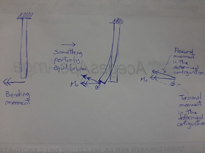

Here is the destabilizing force, in my opinion. If the pipe deflect, a torsional moment appear. As we do when we talk about stability, we can see that torsional moment as a loss of torsional stiffness. If M0 is big enough, the torsional stiffness of the pipe becomes 0 and we have instability.
Of course, the torsional stiffness of a pipe is very big, so M0 has to be very big to have torsional instability. As we said, we have different kind of collapse before reaching a critical torsional point, and that is sure.
Am I wrong?
Of course, if we increase the span, we reach the critical point with a smaller value of M0.
