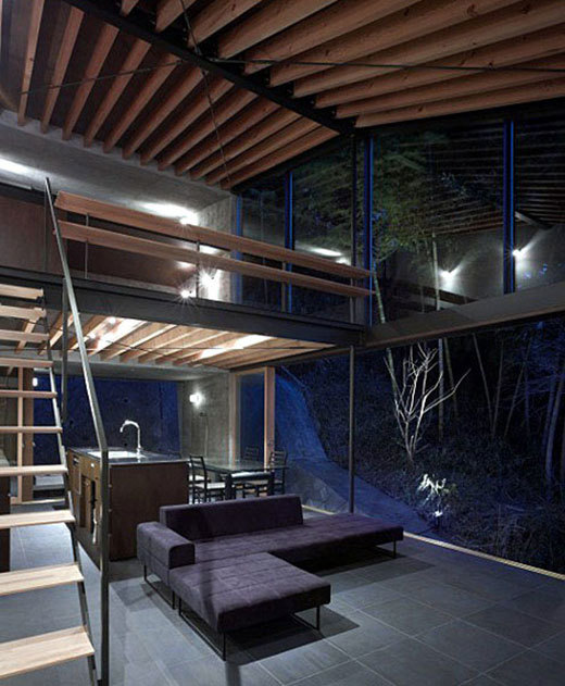

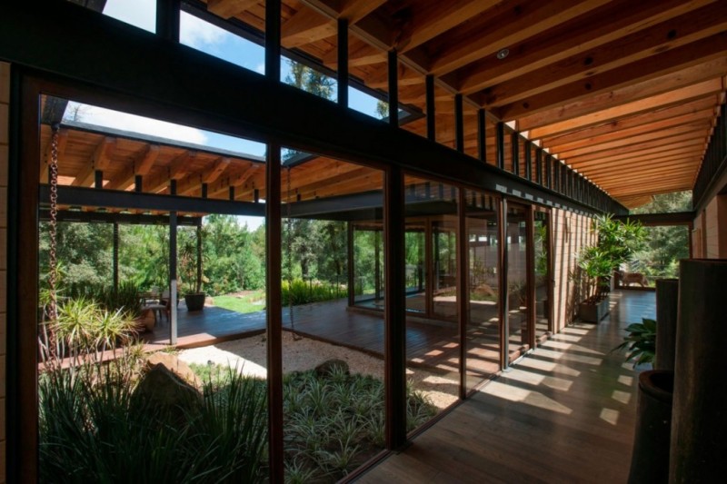

Here are a few examples I found on google search. Not necessarily shear plate connection, but what gets me thinking is long span beams without bracing against rotation.....
Number 1.
Are those steel beams? Hard to see. Looks like glulam beams to me. But in any case, there would have to be fixity between the columns and the beam. Otherwise, the structure is unstable (four hinges in the column).
BA
Number 2.
Again, they could be glulam beams...not clear.
BA
Number 3.
Aha! Now we have some steel beams; but the two grey looking beams are not carrying any load. Since they are attached to a column, they may be (probably are) prevented from rotating about their longitudinal axis.
The beams supporting the floor structure are continuously braced on the top flange. So where's the problem?
BA
I thought Picture No.1 and No.2 are steel beams (looking at the I shape ! ) .... My mistake if they are not...
As for Picture No.3 : I was under the impression that both flanges must be braced (Am I wrong?) .. If the top is braced continuously by the top flange, shouldn't the bottom flange should have some sort of support against rotation too ? (Logically I think no we don't need since the top flange is assumed to be wide enough to stable the beam..... I may be wrong ....)
What about if the beam loaded with a glass on the top (Picture No.3) was to support a floor slab instead of the glass, would it require a brace for the bottom flange ?
Thank you !

@NewEngineerHere:
No. 1 is described thus: "Warm Corridor With Timber Deck And Wooden Exposed Beam Ceiling Also Glass Wall Panels And Overlooks The Beautiful Zen Garden Design Ideas". Doesn't sound like steel beams.
No. 2 is too dark to discern much of anything. If the beams are steel, the top of the upper beam is braced by roof joists. The lower beam, if steel, would need to be prevented from torsional rotation at each end. The beam would need to be capable of carrying the design moment with an unbraced length equivalent to the span.
The beams in No. 3 appear to be simple spans. The bottom flange is in tension and does not require bottom flange bracing whether it supports a floor or not.
Continuous beams may require bottom flange bracing in the vicinity of inflection points but not necessarily. If the beam section is stocky enough to carry the load without bracing, then bracing is not required but torsional rotation must be prevented at the supports.
