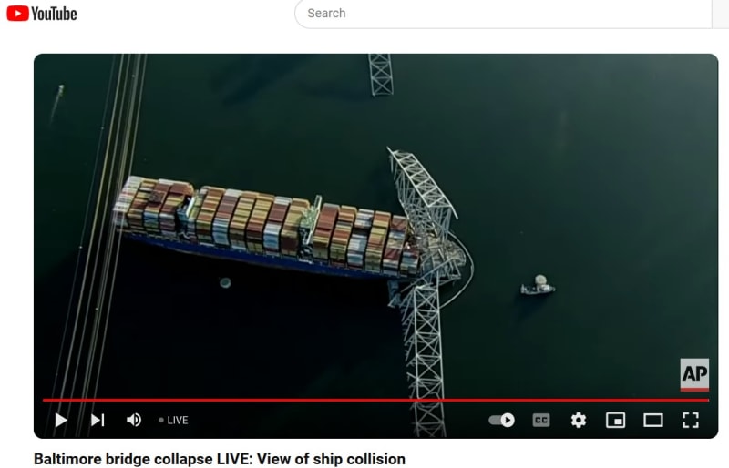

The bridge and pier, as un-intended as it was for that purpose, stopped the ship.
I just want to add some nuance to this [smile]. The ship hit the pier and a relatively small part of the bridge. From what I have seen I would say that the bridge failed because it lost its support. It seems to have dropped mostly downwards.
Most of the impact energy was handled beneath the water surface. Perhaps the pier was part of a much larger structure. I am just speculating since I have no more information than the videos.
