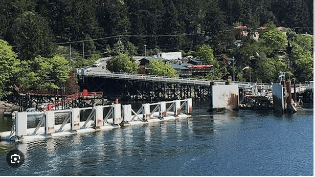

The dolphins are supposed to make the ship absorb its own impact, rather than transferring it to the bridge supports. These articles show some of the dolphins at the Sunshine Skyway Bridge which were installed after the old bridge was brought down.
Tomfh said:
How do the dolphins work? Where does all that energy go?
Some will be lost to ablation of the dolphin. Some will be used deflecting the ship to the side (it's unlikely to be a perfectly aligned hit, so it's going to be to one side of the ship's centerline). The rest goes to tearing away shell plating and turning heavy steel into mangled scrap.
That's assuming the dolphin is securely attached to the planet. Build quality may vary.
As someone notes... a ship of that mass travelling at that speed, will require a really big dolphin... [pipe]
I have seen dolphins bend and rebound when impacted by a large ferry.
I used to ride a ferry every week.
As memory serves the capacity would have been about 80 cars and 600 passengers.
At one side of the approach to the dock were a line of dolphins, at the other side one or two dolphins.
At times a "Cowboy Captain" would come into the wharf too fast and scrub off speed by hitting a dolphin a glancing blow.
The dolphin would deflect and rebound.
The rebound would push the ferry across to the other side were it would sideswipe one or two more dolphins.
That, combined with bow thrusters and/or reverse thrust would slow the ferry almost to a stop.
Most of the energy and speed lost would be scrubbed off by the redirection of the mass of the vessel to an altered line of travel.
These dolphins were not solid concrete but the old school, driven pile dolphins.
That is, a large number of driven pilings were bound together by cables.

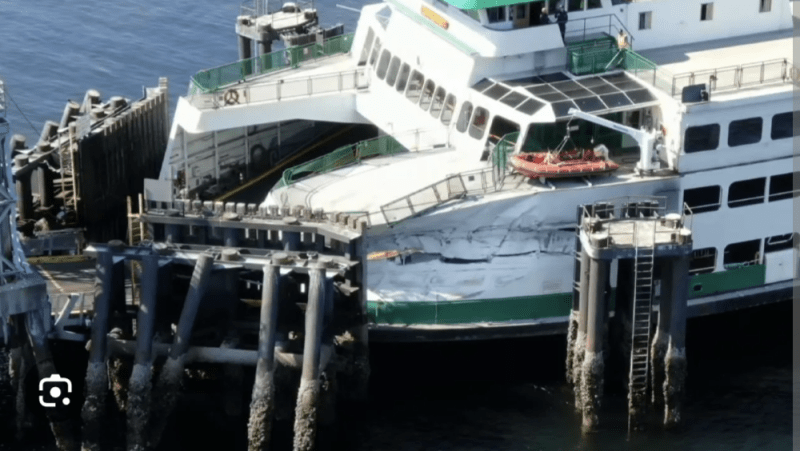

Here is a recent example of the results of a ferry using whalers as brakes.
I was there Tug.
I saw the dolphins bend/deflect several feet as the ferry hit a glancing blow.
The dolphin then rebounded and the ferry hit the dolphin on the other side a glancing blow.
A small part of the energy may have been dissipated by the shock absorbers of 80 cars rocking from side to side.
Not a lot of energy, but a strong indication that the vessel had been redirected.
A normal landing would rely on the bow thruster and reverse thrust.
When the ferry was obviously coming in faster than usual, we would do the dolphin bounce.
A lot of the old dolphins have been replaced by these rebound structures.
These are not intended to take a direct hit but work very well when struck a glancing blow by a ferry.
Ohm's law
Not just a good idea;
It's the LAW!
That damage was not done at that spot.
That vessel hit something lower at another time.
Our ferries had substantial rub rails.
The dolphins had lots of rub marks.

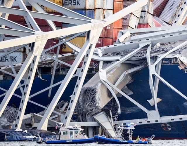

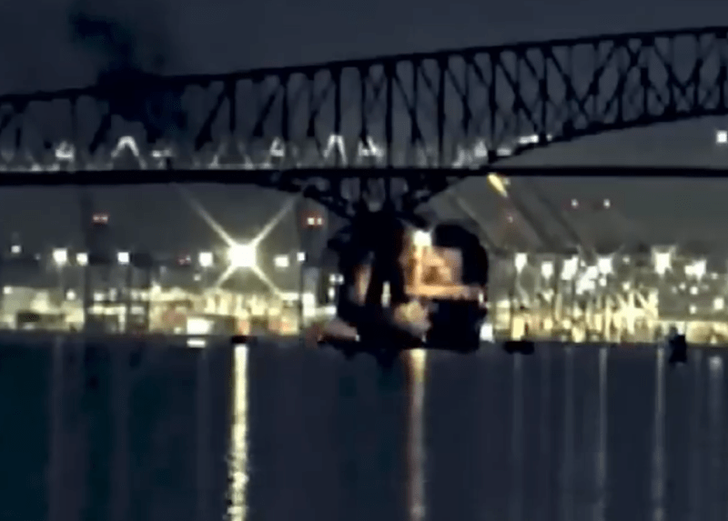

From the recent NYSB footage it appears the demolished pier's marine works, that is the pile caps and the vertical and raking piles underneath the water (or the cassion structure if used), remains intact. The fender system seems complete and there is no visible movement in the pile caps. Only the twin A-frame columns were removed on impact. All four reinforced concrete columns were broken off cleanly. Three of pile caps are now visible with separation face at about 45 degree. Only one column is visible now lodged with the bow of the cargo ship. It is trapped by the falling deck. It is also possible that the deck may be covering some of the remaining three columns which appear to be hollow in section [see post by ZR Shipwright (Marine/Ocean) at 26 Mar 24 15:12] or the photo re-posted below. The RC design code ACI-318 has in recent years has tightened the requirement of stirrups or lateral links, like every alternate vertical bar in compression bar has to be confined by a link, which are glaringly missing in the failed column.
The enhanced video provided by NTSB also shows two locations where materials and dust were blowing away like explosion during impact. This could occur if the RC columns were heavily loaded in compression and failed by buckling.
