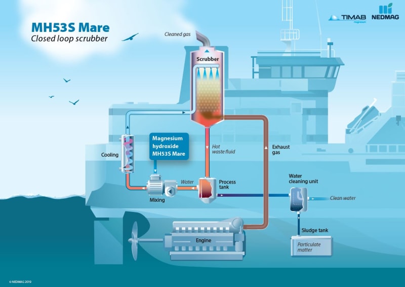

Marine scrubbers exist only to strip Sulfur gas from ship exhaust. The clip below is one closed loop version. There are also open loop versions.
It may be that one scrubber serves more than one engine. That would explain the dampers as they
would be necessary to keep exhaust gas from an on line engine from backing up into an off line engine. If the arrangement is relevant to the accident story eventually the NTSB report will provide a description of the arrangement used on the Dali.

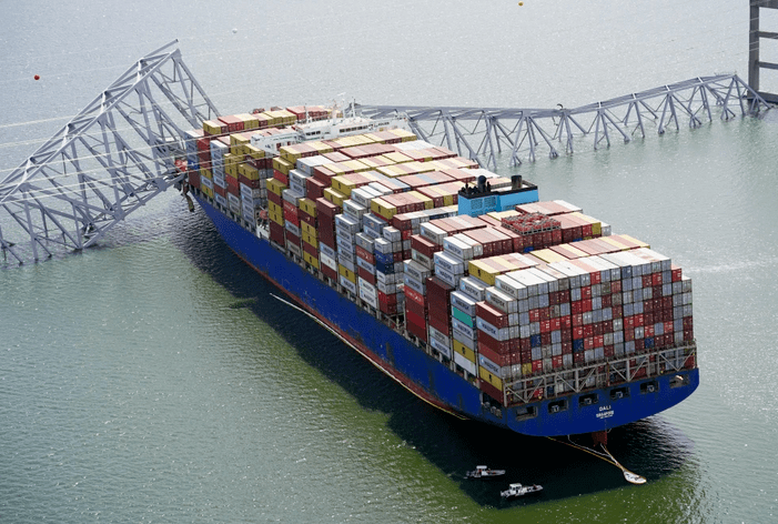

This is what the NTSB says
"While working on the diesel engine exhaust scrubber system for the
diesel engine driving the only online generator (generator no. 2), a crewmember
mistakenly closed an inline engine exhaust damper. Closure of this damper
effectively blocked the engine’s cylinder exhaust gases from traveling up its stack and
out of the vessel, causing the engine to stall."
Now we have also found out that the EG which I can only assume kicked in only powers the fuel pump for the no2 generator....[I'm sure I read this somewhere and it kind of makes sense but can't lay my hands on it. Hence why DG2 came back on line when in port and when DG3 and 4 failed when sailing due to loss of fuel pressure.]
Hence when no 3 started it had no fuel pump working and then ran out of fuel pressure before the 440V system came back on line and the fuel pumps restarted.

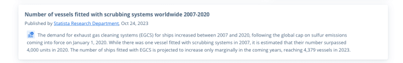

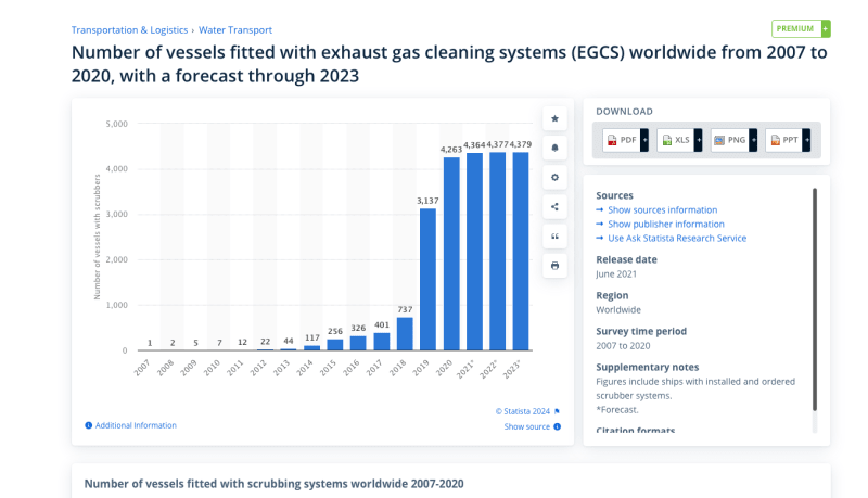

1991 for the first prototype scrubber on board a ship:
Five years before your date and two years before Dali was built:
I found plenty more examples.
My research was inconclusive on the specifics for Dali but if the designers and engineers who built it couldn't look ahead and include scrubbers or at least provisions for future modifications then they really dropped the ball. Anyone could see that tougher regulations were coming.
Any scrubber retrofit will need extensive engineering to ensure all regulations are met and documented for compliance in all ports they may visit. It's not just a kit you order from Amazon and install on a weekend without verifying that it performs correctly and without compatibility issues with other systems. MY thinking is that proper engineering would not question if the emergency generator was MAN enough because scrubbers wouldn't be required in an emergency.
Still waiting for evidence specific to the Dali, not HMM Promise or any other ships or manufacturers...
Dali was delivered in Dec 2014, so you can see not many of any kind of ships with scrubbers in 2014............

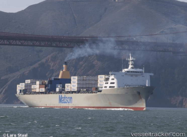

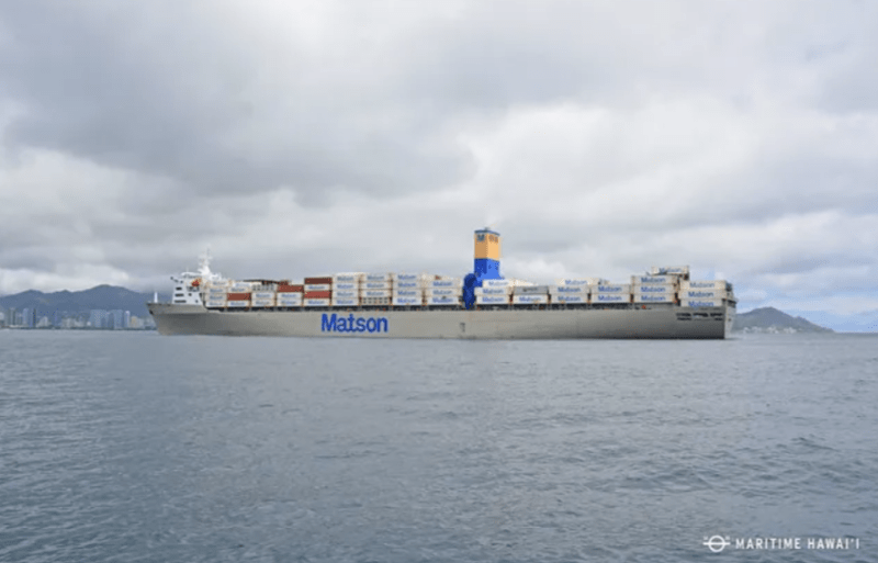

Nukeman, emissions regulations apply broadly to all ships under IMO. USA has stricter rules under EPA and Air Resource Boards. All ships entering control zones are required to follow the same set of rules. Scrubbers are only not required if the ship operator chooses to burn low sulfur fuels. Here in California I see ships built in the early 1980's with retrofitted scrubbers. The stacks on the retrofitted ships are comically large.
After and before:

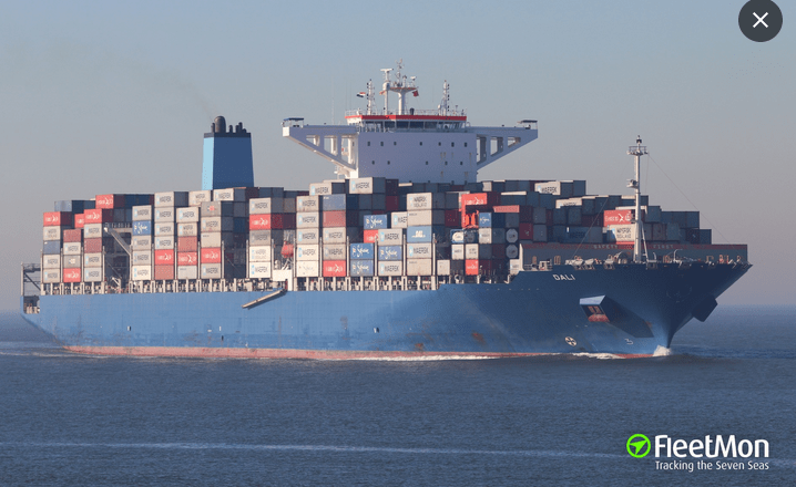

Thanks Tug.
That is actually strong evidence that the scrubber was a retrofit. By looking at the actual ship in question in old pictures it looks like the extra equipment was added to the starboard side of the stack.
