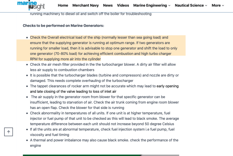

Could the sudden loss of load on DGR3 and 4, be the cause of the black smoke due to loss of all electrical loads on main generators?
I believe this article also mentions turning off one generator when loads are too low for two generators, to ensure turbo is spun up sufficiently to create proper fuel to air ratio. Or did a ship mate close or open the wrong manual control device, at that the wrong time, in preparation for open sea conversion to heavy fuel oil?
I have highlighted the load scenario in the screen shot below, and provide link to the Marine Insight article.

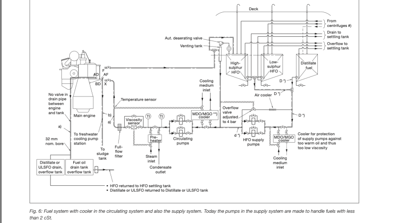

I have also included a MAN Dec 2014 Service letter concerning low sulfur fuels and low viscosity distillate fuels.

Bottom line is it appears effects of running multiple fuels and tuning of engines to run on different fuels is a very complex process, and perhaps with a lot of manual intervention to control the process. So plenty of room for human error, in spite of automation systems, just like the exhaust damper was incorrectly close in port?
It would be colossally stupid and illegal to change fuels while maneuvering. I don't think this is an avenue that needs to be explored.
I think it was Chief Makoi who even spoke about changing fuel types in a video a while back. It is not an instantaneous switch--you have to do it gradually (meaning the fuels are mixed during the process), so it takes a while to complete. There is an (old) Kongsberg MC90-V engine room simulator (you will find a ton of videos on this on YouTube--I think even Chief M has used it to illustrate some things in the past). This simulator does simulate the changeover process, amongst other things, and from what I remember it takes well over an hour. I have that simulator installed too, have not re-tried changeovers (too time consuming). It also does simulate the viscosity controls but I have never quite been able to get that right (I always had a lot of problems keeping it in range).
