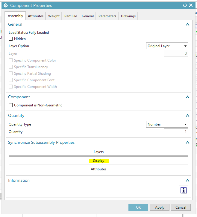

I've got an assembly with component colors (these colors are set when in the assembly). I want to make a mm draft out of this assembly showing these colors...
Is this possible?
Now when I want to make a draft all components have the part color... :(

Make sure that your Drawing is NOT using the 'Monochrome' option.

John,
I've checked the monochrome option is off....
I 've pushed this button and it worked...(in yellow....)
