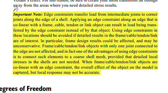

Question No.2... I have read this in CSI manual about area edge constraints,does that mean that constraining my area objects on edges does affect my structure?
Thanks for your help in advance
by structure i mean my frame section elements,sorry about my english
