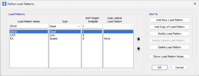

I am developing an application using C# with SAP2000 API v26.2.0 and I've encountered a problem with creating Load Patterns that should normally be very simple, but which I haven't been able to solve. I would greatly appreciate any assistance you can provide.
Problem Description:When I create a new SAP2000 project programmatically via the API and add new Load Patterns using the mySapModel.LoadPatterns.Add() method, these Load Patterns successfully appear under the "Define > Load Patterns..." menu in the SAP2000 interface. However, these newly added Load Patterns are not listed in the "Model Definition > Load Pattern Definitions > Table: Load Pattern Definitions" table, which is accessed via "Display > Show Tables...". Only the default "DEAD" load pattern remains visible.

- The load patterns are correctly listed in the "Define > Load Patterns..." window (please see the attached screenshot). This indicates that the API call was successful and the load patterns were added to the model.
- However, the "Load Pattern Definitions" table (please see the attached screenshot) does not display the newly added load patterns like "LIVE", "EX", etc.
