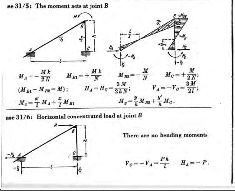

in 8, wouldn't Ha = -Hb ?
9 is showing that the triangular truss reacts the applied load as an ideal truss ... the inclined member will react the applied load, and the horizontal member carries the horizontal component on the inclined member load.
That seems right to me. Otherwise horizontal forces are not in equilibrium.
Edit: I don't believe moments are in equilibrium for Case 8 either. Looks like an error in the Air Force document.
Edit #2: Correction, see direction of forces and moments below.
BA

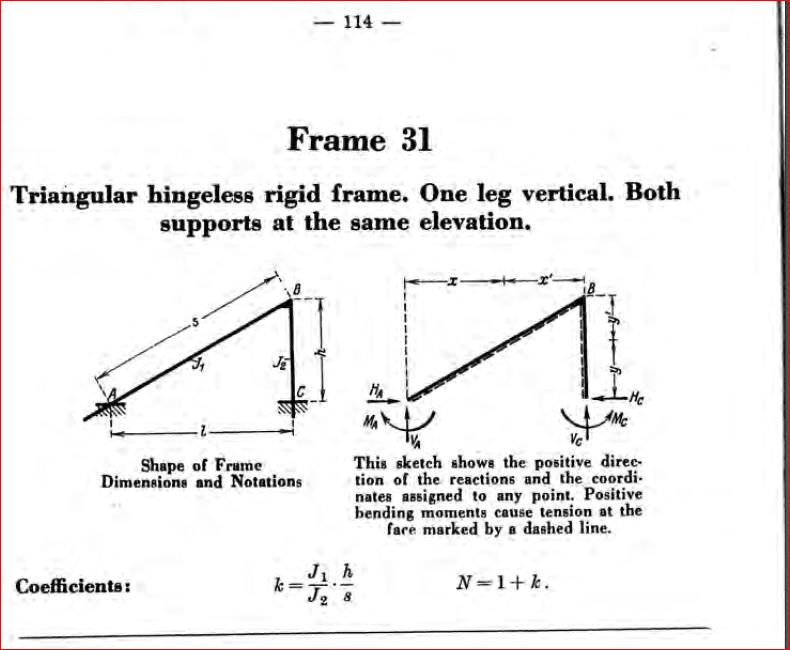

Kleinlogel Frame 31
Naming of nodes and members differs from Air Force document. Symbol J stands for moment of inertia (instead of I).
Coefficients
Case 5 and 6...corresponds to AF case 8 & 9

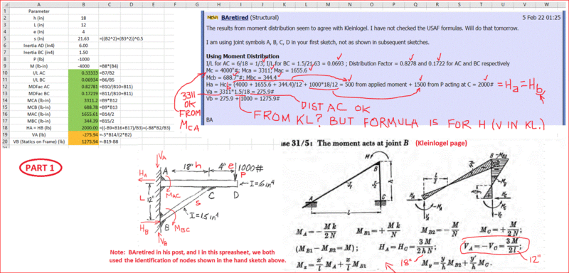

Greetings, everybody,
I apologize about my delay to reply, in the past two weeks I had to work mostly in another project, but managed to squeeze some time to do new calculations based on the replies I received here, for which I am grateful. But finally today I can post an answer, unfortunately not with good news.
I am attaching my calculations of a bracket example with easy dimensions and a load, all are completely different from mine, but they are easier for testing purposes. Initially, I thought that I was on the right track because, with the last clarification from BAretired, thanks for that, I was able to get the formulas I previously had of the Air Force Manual, Table 5-5, cases #8 and #9 to work well by doing a = 0 and d = 0, as s/he indicated, and you are right that Q is not defined there, I had also noticed that, but this doesn’t matter as you also wrote because d = 0 in this case. They work well because the combination of those two cases gave me a set of six reactions that made all Statics equations (summations of forces in X and Y, and of moments) of my situation with force on the overhang, equal to zero. To do that, I did a summation of moments for the inclined brace only, to obtain the unknown internal moment between this member and the horizontal one, and plugged this result with opposite sign in the summation of moments for the horizontal member, and the result was zero. Of course, that made me happy. Later, there was another post by BAretired, thanks also for this one, which mentioned a book by Kleinlogel, and I could download a PDF file of it from internet. It seem to be an excellent reference, the same as the AF Manual. The frames BAretired mentioned, 31/5 and 31/6, match my configuration, so there is no need to do the adaptation with a = 0 as with the Air Force Manual, but once again those two cases have to combined. I did the same as before with the six reactions to obtain the internal moment at the welded joint of the brace to the horizontal part, and again introduced this result in the summation of moments for this member, and got zero again. However, only the horizontal forces are the same between these two methods, the vertical forces and moments are different. I thought this was odd, as I always thought that the solution set of reactions for a Statics problem would be unique. But I thought that maybe there are two solutions for a statically indeterminate problem like this one. In the attachment I am showing the equations to verify the combined reactions from both methods. But, as I continued thinking about this, I did an experiment, I kept the horizontal forces, because the results are the same in these two methods, but put arbitrary vertical reactions and support moments that satisfy two rules: that the sum of the vertical reactions is 1,000 lb going up so they can oppose the external load, and also that the sum of the support moments is 2,000 lb-in clockwise so it can be added to the 22,000 lb-in from the external load to cancel the 24,000 (2000 x 12) lb-in CCW at the wall support of the brace. Initially, I tried with three combinations of reactions, all of them within the limits of the absolute values of the combined reactions obtained from the Air Force and Kleinlogel, and all of them worked, so I thought that those values could be the boundaries of the reactions, and this would be useful to calculate the stresses, but later I tried a set with all vertical forces and moments outside of those limits, and it worked also. So, I ended where I started, not being able to determine the reactions and moments. Both the Air Force and Kleinlogel work by themselves, but not getting matching results, and the infinite other solutions that also work, makes me call for help again. I am sure that I am making a mistake, but don’t know which.

@nargonaut7,
I am sorry you are having so much trouble with this problem, as it should be fairly straightforward. I think you deserve a medal for tenacity. I intend to have a closer look at the problem over the weekend (if someone doesn't beat me to it).
BA
The results from moment distribution seem to agree with Kleinlogel. I have not checked the USAF formulas. Will do that tomorrow.
I am using joint symbols A, B, C, D in your first sketch, not as shown in subsequent sketches.
Using Moment Distribution
I/L for AC = 6/18 = 1/3; I/L for BC = 1.5/21.63 = 0.0693 ; Distribution Factor = 0.8278 and 0.1722 for AC and BC respectively
Mc = 4000"#; Mca = 3311; Mac = 1655.6
Mcb = 688.7"#; Mbc = 344.4
Ha = Hc = (4000 + 1655.6 + 344.4)/12 + 1000*18/12 = 500 from applied moment + 1500 from P acting at C = 2000#
Va = 3311*1.5/18 = 275.9#
Vb = 275.9 + 1000 = 1275.9#
BA

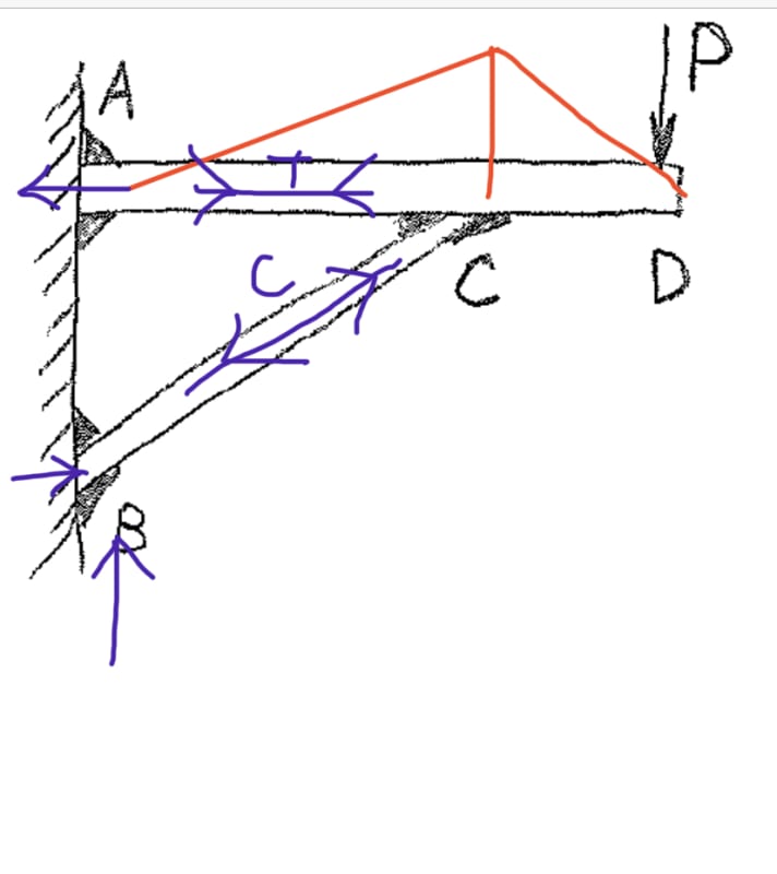

So i’m going to pin the supports and the joint from the diagonal and allow the top horizontal member to cantilever over as shown.
Job done, keep it simple.
Moment in red, axial in blue.

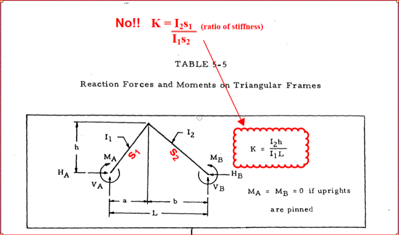

The 'K' term is incorrect in Table 5-5 in the USAF document (see below) so any values involving K will be wrong as well.
I agree, MIStructE_IRE that keeping it simple is best when designing a new bracket. But, when checking an existing bracket with rigid joints, this could be useful.

But well, back to the present calculations, after BAretired indicated that the K factor of the USAF Manual is wrong, I verified that, in the case of an applied moment, USAF Case (8) and Kleinlogel Case 31/5, with the K factor as defined by Kleinlogel, and using it at the USAF formulas (that is, with K = 0.208 instead of the original 0.375), the results match between both methods for reactions V and M, but they are still different in reaction H, and this is because the USAF manual has that factor K in both the numerator and the denominator of the formula, while Kleinlogel has that factor only in the denominator (“hidden” inside the N factor). So, I am not paying attention to the USAF Manual anymore, at least not for this bracket, even if it still seems an excellent reference for many other situations. I think that the discrepancies that BAretired has found in this Manual could be solved if we could check the reference that they mention, which is William Griffel’s “Handbook of Formulas for Stress and Strain”, but I haven’t found this book.
So, as I show in the attachment picture (I am sorry about its large size, we have to zoom to read it, and then it doesn’t fit in one screen), in Part 1, I was able to reproduce BAretired’s MDM calculations where I put red checkmarks, I did this in the Excel cells marked in green (the formulas I used are to the right). But I couldn’t follow cell B19, marked in orange, because the formula s/he used, with that 1.5 factor, is from Kleinlogel but for the V reaction, which is horizontal in our case, and the book formula is with the external moment when s/he used the internal moment. I am not saying that what s/he did is wrong, it is just that I don’t know where this formula comes from, because I thought that s/he was applying MDM but I have only found a similar formula in Kleinlogel. Actually, when I first read this post, I didn’t understand why the four moments have the values indicated there, but then I found the book indicated in Part 2 of the attachment, and there I studied the basics of the MDM method, I pasted the two key principles there (formulas 9.15 and 9.16), and with those now I understand those moment values. I even tried, but very clumsily, I recognize that, to apply the sequence of successive approximations of the MDM method to obtain moments Mac and Mbc as I also show in this Part 2.

nargonaut7,
This is not a difficult concept.
Considering only the Moment Distribution Method, the 1000# load is shifted from D to C and a moment of 4,000"# is applied at point C. The effect of that combination is equivalent to the actual applied load at the end of the cantilever. The applied moment is resisted by two members, AC and BC in accordance with their stiffness. A carry-over factor places half the moment to the opposite end of each member. No need for any further distribution.
I agree that Hc was a typo. Should have been Hb.
From Moment distribution, Mac = Mca/2 (no further distribution is necessary as A is a fixed end).
Va = sum of moments on member AC/length = 3311*1.5/18 or (Mac+Mca)/18. (not from Kleinlogel)
Note that 3/2 in Kleinlogel is in agreement with 1.5 above. Note also that the vertical member CB in Kleinlogel corresponds to the horizontal member AC in your sketch. In other words, Kleinlogel must be rotated 90 degrees to compare coefficients.
