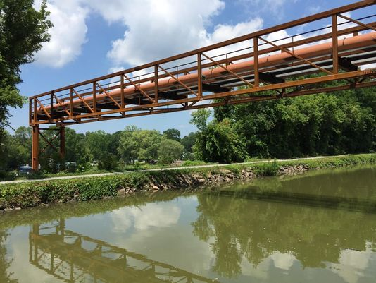

Pipe bridges tend to be built as 90 degree (sometimes 45~) 3 or 5D radius bends, a vertical riser, another 90 or 45 then a flat section across your river, road etc) then the repat on the far side.

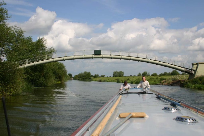

Arch type pipe bridges would tend to be much smaller diameter, short distance 40d curve pipes.

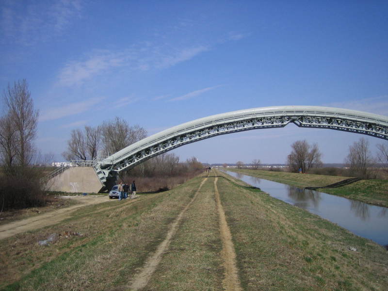

Some do look like this but note the flanges and the large concrete blocks at each end...
But most look like this

@ Littl Inch: the pic of the three-hinged arch is a really great shot.
Too bab you're right, that most pipe bridges look like the last pic.

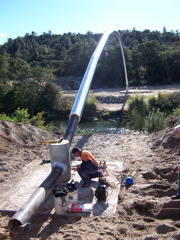

Here is my best river crossing. Much smaller pipe but designed for 180C water.
Wow. That is nice.
Was it cable stayed to resist wind loads or just thick pipe at the base??
What was the mitre angle?
