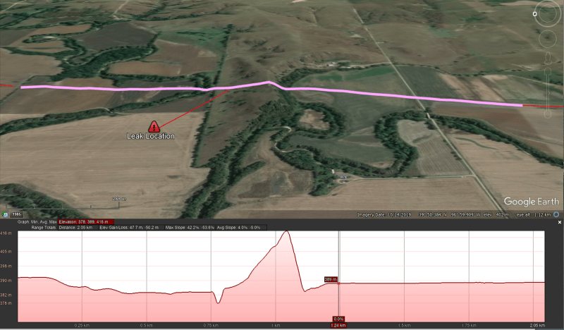

So I wasn't expecting to see this elevation change.
This is not the best kind of profile for pipe stresses.
Two underbends on each side of an overbend of 38m (125 ft)
It doesn't look like they made much of an attempt to smooth off the overbend either.
14,000 bbls is 2.219 miles of pipeline volume.
Leak is
13.8 miles downstream of the last pump station and
2 miles upstream of the next block valve.

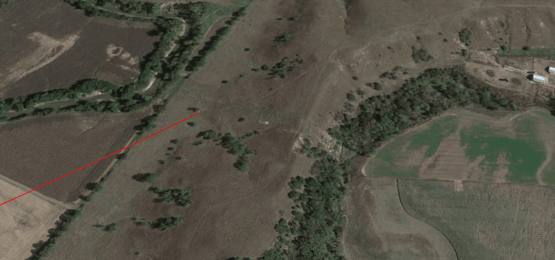

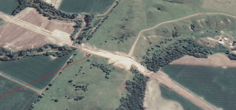

Construction photo Aug 20, 2010
Oct 14, 2019
Dec 2022

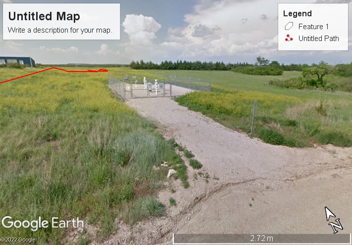

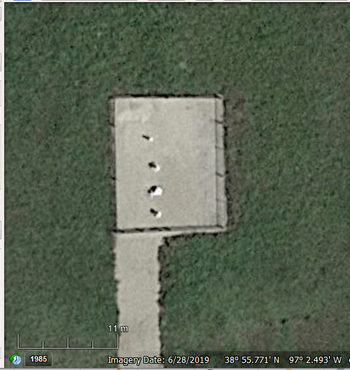

Poor resolution, but I think I don't see any motor on this valve, nor a power source for one.

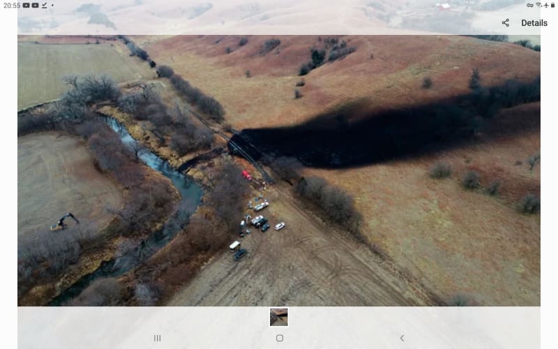

Spill was Dilbit, dilluted bitumen.
More than 400 people are involved in the cleanup.
The response team has so far recovered 5,567 barrels of an oil-water mixture from Mill Creek.
