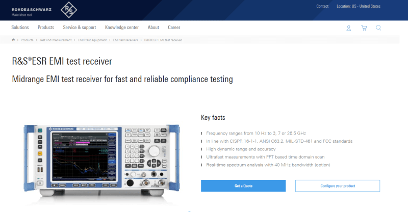

In the USA, you can rent these from most high-end test equipment rental companies. They often also rent the appropriate antennas required to pinpoint EMI sources. We always rent them as they're often very expensive instruments and have a high calibration cost. Plus, there's always a newer (and better) model released every few years! The ownership costs don't justify the amount of use they'd get at our company. Rental is also an easy way to pass on the equipment cost to the client especially when you need specialized equipment to do the work.

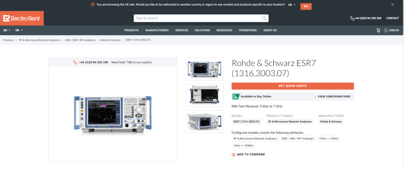

Thanks for your post and I do like the look of the high end EMI Test Receiver the only snag is that I am based in the UK. Do you know if there is an equivalent for the UK market?
If we pinpoint the EMI source and it has a well defined direction, the objective will be to shield that section of the house from the exterior using a galvanised or stainless steel mesh with holes per inch that will be adequate to mitigate or eliminate the undesirable EM Frequency.
I totally get you point about not getting emotionally involved. It was certainly draining when I spent months trying to help my friend come up with a solution to improve his living conditions.
Thank you
another update: I heard back from a main seller of the EMI Line Monitor and he sounded convinced that if I install a couple of dirty electricity filters it will fix the issue. Not sure what to make of that.
It looks like ElectroRent (test equipment rental company) offers rentals in the UK and they have the Rhode & Schwarz EMI Test Receiver (ESR7) available for rent.

At £73 000 these instruments are more for the industrial sector it would appear. I am dealing with an issue in a detached domestic house. I doubt very much that my client would have the budget to even hire the ESR7 not to mention that it would also require a certain amount of training to use it correctly and efficiently. But it’s great to know that these exist, and I will contact the company to inquire about training for my professional development.
