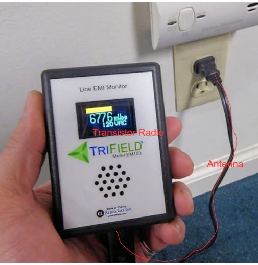

If you are able to find a battery powered meter, connect 10 or 20 feet of wire to the device and trail it around the home.

Another option is a wide band transistor radio with a strength meter. You can scroll through the frequencies and see what you pick up but these gadgets you are enlisting are just a waste of your client's money and fueling an ailment.
