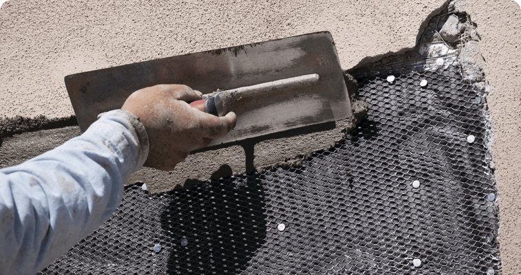

"If the EMI is a radiated field, consider a Faraday shield.
call in a contractor for a quotation to cover the house with stucco.
Stucco is typically supported by either wire similar to chicken wire or by expanded metal.
Either one may be grounded thereby transforming the house into a Faraday shield."

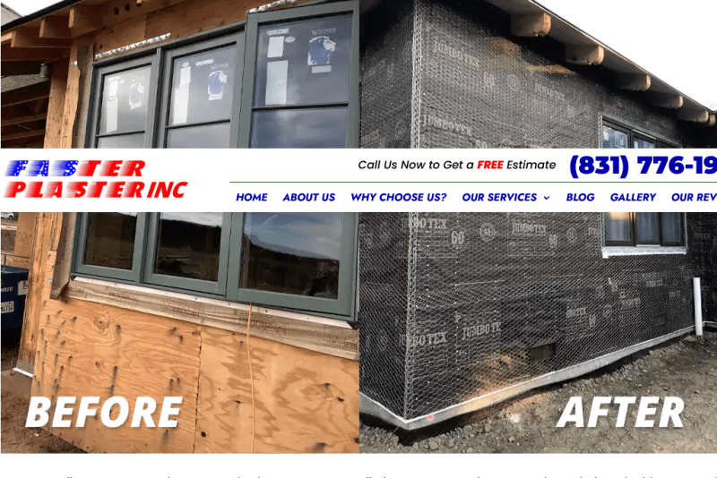

Stucco or render is often applied to wood frame buildings in Canada.
Wire lath or wire mesh is used to support the stucco/render.
any years ago, wood lath was strips of wood about 1/4" to 3/8" thick and about 1 1/2" wide.
These were nailed to interior studs spaced about 1/2" apart.
When the plaster was applied, the plaster would be squeezed between the laths and "key in" the plaster, holding it in place.
Wooden lath was replaced years ago with metal lath "expanded metal).
The same or similar is used to apply render to wood frame buildings.
Screenshot_2024-07-27_at_10-56-08_Discover_the_Benefits_of_Stucco_Lath_Installation_rhsl1w.png
Link Benefits of Stucco Lath

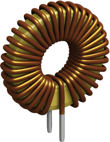

Since the question was asked, the EMI interference problem I was troubleshooting originated in a welding arc stabilizer (a miniature Tesla coil) which generates a high infrequence signal into a welding lead helping to stabilize the arc. The RF signal was radiating off of the work piece, creating a reception problem with some WiFi band equipment.
One solution turned out to be adding a troidal choke to the welding work lead. The choke was made from a plywood doughnut, wound with several turns of welding cable. Imagine the picture below with a core of plywood, ID 6", OD 10" and about 10 turns of no 0 welding cable.
One possible test for your client could be to travel to a low RF noise environment like Greenbank West VA, where a intentional decision was made to minimize RF sources to aid the operation of the Greenbank radio telescope observatory.
See also United States National Radio Quiet Zone
FacEngrPE:
I am not familiar with a toroidal choke how is that wired up? Or does it just sit on the outer sheath like a graphite choke?

Toroidal cores are wound on iron or magnetic doughnuts.
For high frequency work, an air core toroid is much more effective.
For an air core toroid, the core material is relatively unimportant as long as it is not magnetic or conductive.

Thanks for the info on Toroidal chokes. Will have to do some background research on those.
