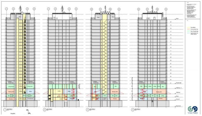

The typical residential floor has (had!) 4 x 2-bedroom apartments and 2 x 1-bedroom apartments for a total of 120 units over 20 floors.
One exit fire-stair only that served the residential floors.
A new exit stair was added recently to serve L1 through L4 community-type common areas.
No sprinkler system, only one exit, flammable cladding, inaudible fire alarms, instructions to remain in place, inability of fire fighters to access upper levels. Maybe I left something out, but sounds like a classic definition of fire trap.
Sadly, that is the indeed the truth, hokie66.
The original 1970's concrete framing and existing precast concrete facade appeared to perform well for the duration of the inferno.
2012 Planning and Permit drawings from The Royal Borough of Kensington and Chelsea website: Link

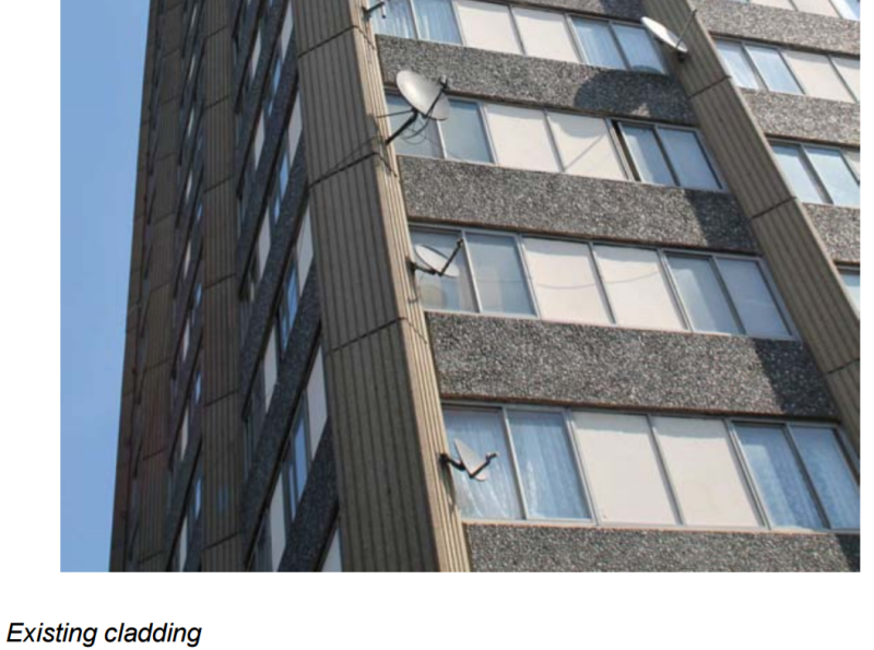

Existing 1970's facade was horizontal STRUCTURAL perimeter precast spandrels and precast non-structural triangular-shaped column panels:
The Royal Borough of Kensington and Chelsea said:
The existing tower has a concrete structural frame with precast concrete panels forming the external cladding to the residential floors.
For the upper 20 storeys precast concrete cladding has been used: one panel type serves as a structural spandrel under the
windows (horizontal) and the other is a decorative facing to the triangular pilasters, each a full storey height of 2.6m (vertical).
Good find, Ingenuity. It does look like the concrete building and precast facade elements performed well, but they weren't pretty, and didn't insulate well. And the windows leaked, so the facade refurbishment was necessary.
According to those documents, there was to be 150mm of Celotex FR5000 insulation on the spandrels, and they specified a composite zinc panel over the insulation, not aluminum. Will be interesting to see a report, which I imagine will be made public in due course.
If the building codes allow for that type of floor plan, they are totally wrong and should be changed.
