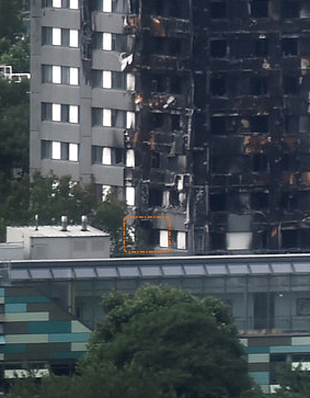

24-level building tower fire in West London 33
Ingenuity
May 17, 2001
2,374
Link
Looks like the building is fully engulfed. Residents trapped in the upper levels.
40 engine and 200 firefighter response.

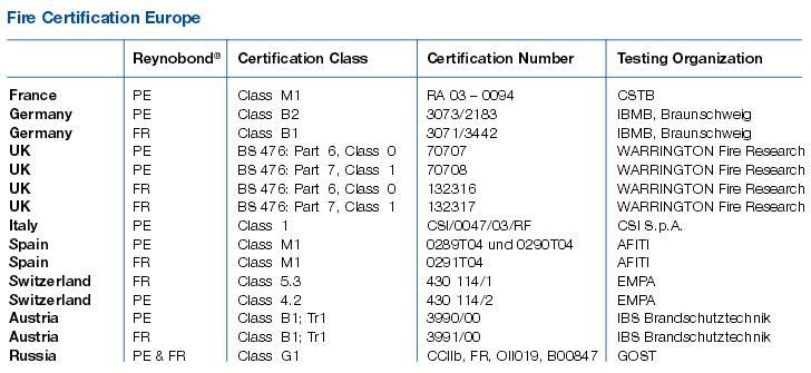

I guess we will have to wait & see just how many other structures have the same combination of Celotex RS5000 & Reynobond PE. With two large companies like Arconic/Alcoa & Celotex; there are surely to be more. If an architect or engineer were presented with a list of 20 other buildings where the two materials has been used in a similar applications, they would have to be quite knowledgeable on the subject to not feel somewhat compelled to accept such a submittal. Finding themselves in a defensive position. Something has gone terribly wrong with the concept of Unconscionable in the UK Building Design community. Worse, the powers that be in government, don't have the good sense to realize they are completely out of their depth at making determinations about building safety and should stick to choosing colors they like.
Having just read up on how fires are dealt with, one of the primary concerns for the crew at the point of attack, is reducing the volume of smoke and heat in the affected area. Venting the fire, as close to the fire as possible is a standard tactic. Yet, it can be argued that, the use of Polyethylene ACM cladding, completely changes the manner in which firefighters can extinguish a fire in a dwelling. Not being able to vent a fire for fear it will set the exterior on fire, greatly increases the danger for the firefighter and the ability to contain the fire to one unit in a multi-family dwelling. It is entirely possible the London Fire Brigade vented the Grenfell Tower fire and the flames set the bottom edge of the 4th floor ACM cassette on fire. On the whole there is comparatively little exterior damage to Flat 16 where the fire originated.

"Combustible cladding has been permitted based on reports arguing fires involving combustible aluminium panels would behave similarly to ones with non-combustible ceramic tiles.
Developers use them to persuade inspectors to sign off buildings.
Exova, the company that produced the reports, refused to comment.
The company, also known as Exova Warringtonfire, is a fire testing and engineering company."
Dik
I saw that. I don't know how you can compare metal faced panels with ceramic tiles. Two entirely different animals.
