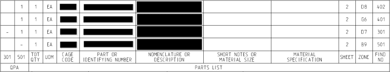

I'm wondering about the method of using different levels within a single drawing for sub-components or sub-assemblies. It allows for a way to reference an interim item that doesn't have a part number that is fed into another assembly.
This can be used on large or assemblies or weldments. For a simple example, P/N 39280381 is an assembly. It is a piece of sheet metal that is cut to size and bent, then some press in fasteners are added. The method I'm trying to think of allows for the interim piece of cut sheet metal to be given the pseudo P/N 39280381-100. There can be other layers to the assembly that would use -300 and -500. It's been a while since I've seen this, so I'm not even sure I'm describing it correctly. Just trying to remember the name of the method...

The attached image is from a Lockheed drawing. The 301 and 501 assemblies would not be in the ERP. They are just a way to reference a sub-assembly within the drawing.

Hi, BrysonRD:
Those are just numbers for items. You can use any numbers you want to as long as they don't cause duplicates.
-100, -300, and -500 are an old school way to create intelligent item no. They are good for easier recognition by humans, but no good for automation.
