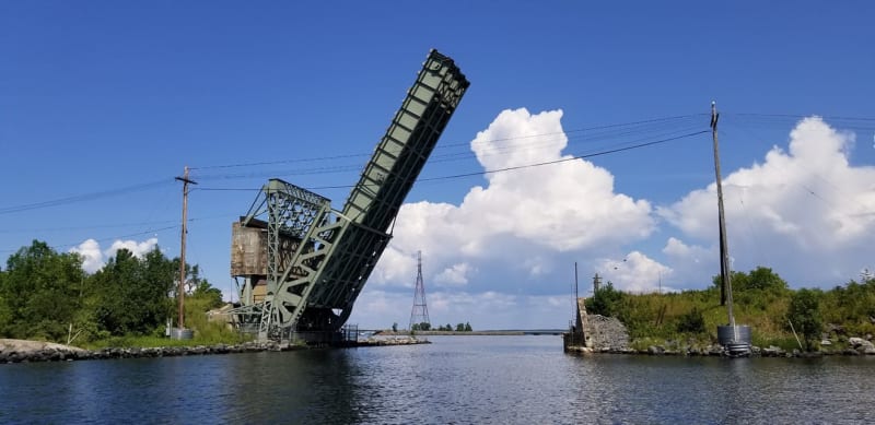

Finding some pre collapse photographs was hard. I eventually found these.

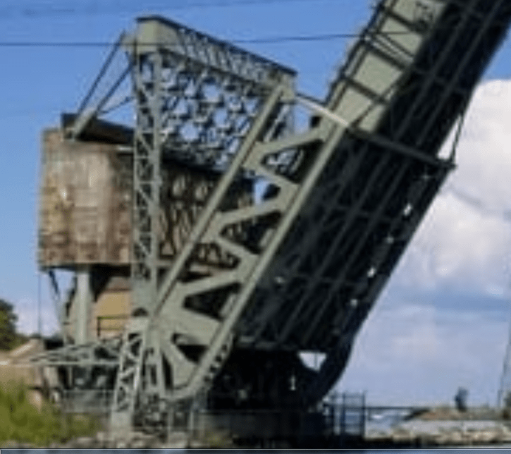

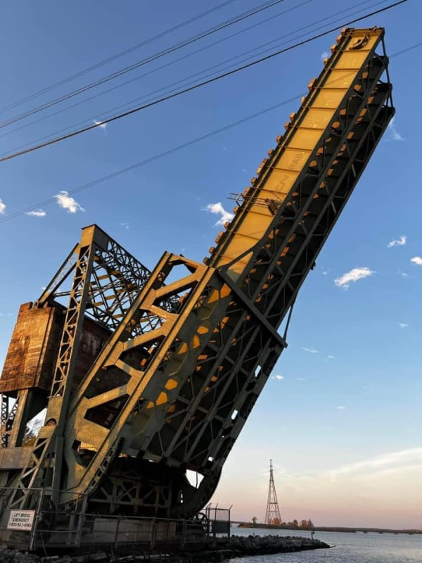

Looking at the latest pictures posted by Human909 it appears that the counterweight is passive.
That is, it does not move with the drawbridge as the span opens.
The counterweight position does not change as the drawbridge opens.
It appears that the span may be opened a crown and pinion gear set.

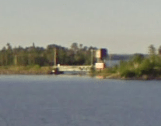

Its actually here
So 5 mles from international falls onthe Canadian side of the border, not rainy river.
Looks to me like it was left int he up position as a default to allow boat traffic under
We can only assume the connecting rods failed for some reason.
Not sure how it operated though - difficult to find any information it. You can / could see it fromt he highway accross the lake if you go into street view.

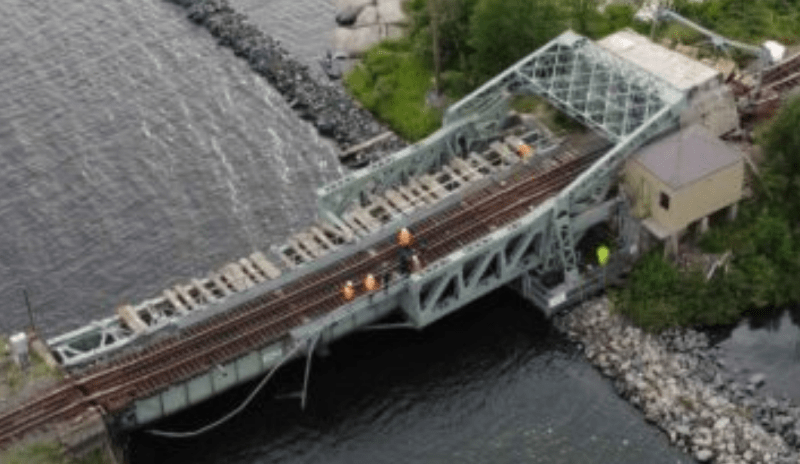

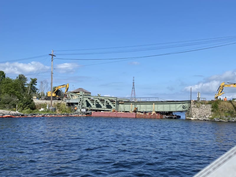

Looks like they are busy repairing it any way. Old structure already gone!
Oops409. The pictures you have posted above are not the same bridge. It is a nearby bridge but not the same one.

There doesn't seem to be any connecting rods to fail.
I don't think anything moves in the counter weight.
It's pretty clear that the "normal" position of the bridge is open. Every shot you see has it open. So this is where everything is in a "neutral" position.
SO I think the thing is just very well balanced and rotates around its hinges with minimal hydraulic effort - so a bit like Tower Bridge in London and a lot of these bascule bridges.
If a train went over it apparently according to old Casey just before they heard a bang it sounds more like this was on the opening procedure and the counter weight mechanism just seems to have completely broken free of the bridge structure and fallen backwards with the bridge at maybe part height then falling and collapsing.
So corrosion hidden in the structure seems a more likely explanation. The thing looks to b similar to the 1908 bridge so over 100 year sold, next to a lake and where it gets pretty cold in winter and hot in summer.

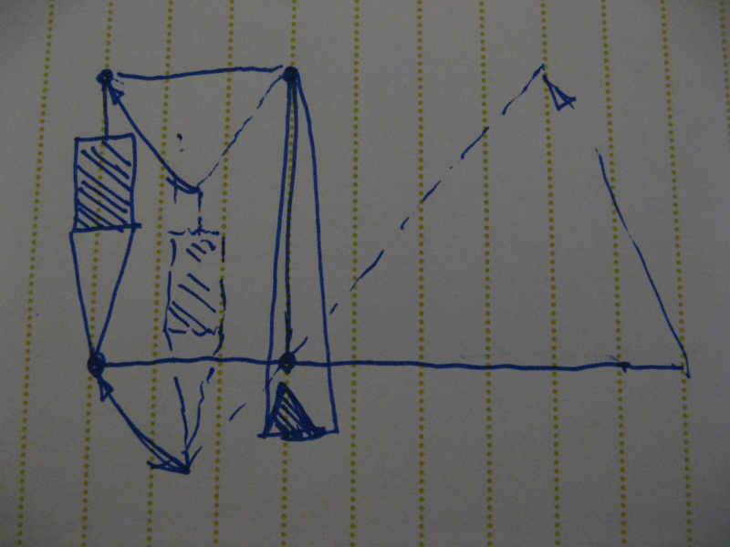

In the London Bridge, the weight rotates with the bridge. But that requires room underneath for the weight to go. This is too close to the water for a pit large enough.
Note the tilt of the upper counterweight support matches the tilt of the bridge and that the lower counterweight support isn't one that would be stable; it's on a V with the point down.
It's a bit confusing because the house is behind it and I've found a GE image of the bridge down and fair enough, the counterweight thing doesn't move with the bridge, but does seem to go up and down.
If you go to GM and streetview on the bridge and then different dates and then move along the bridge you see it move and the weight goes up. So maybe some sort of hydraulic lift or just a mechanical connection resting on the end of the semi circular end of the bridge.
Actually int he side view you can see the struts connecting the weight to the bridge and the weight to the lattice structure. So it hods it vertically as it moves.
