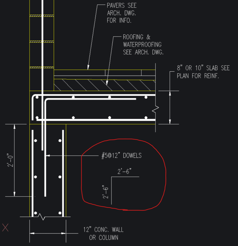

Question:
Why do some engineers use significantly longer 90 degrees hook lengths than is required by ACI code? For example, having the leg be 24" long for #5 bar, when only 10" is needed.
Background:
Per ACI 318-14,
So #5 needs 10". This is also shown in CRSI manual. However, I've seen two different firms use 24" for both #4 and #5. It seems excessive. I think there must be a reason for it, like it's easier to cut or something. Or maybe it's a regional thing, where "my grandfather did it this way for 1000 years" so everyone does it. I'm in the east coast.

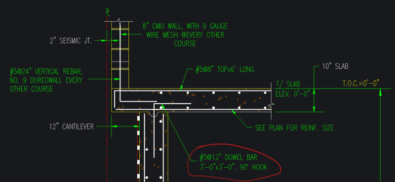

Sorry, I should've clarified what I'm looking at. It's dowels between two pieces of concrete, like foundation wall to footing or shear wall to slab. (I know there are other issues with the details below. I'm not looking for that kind of feedback; I'm working with the original engineer to fix it.)

With that detailing, the bars in question may be to transfer diaphragm shear into the supporting walls. The slabs are likely not thick enough to justify that the bar is fully developed in the slab section with std hook geometry
There's a common misunderstanding that I've noticed, whereby as long as the total length of the hook and the straight extension exceeds the development length, you can consider the bar fully anchored.
Which is obviously not correct and I see it being abused all the time in situations where there is not enough room to get a bar to develop, so people will just keep extending the tail of the bar until they get enough overall length.
Unless you are providing a larger-than-normal bend diameter (>10*db if I remember correctly), the reinforcement can't be considered to continue developing along the tail of the bar.

This is relevant to the detail you provided - the bar from the wall to slab is way underdeveloped inside the slab as the hook is so close to the bottom

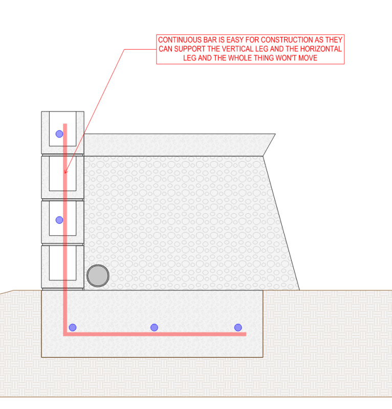

To me, the advantage of using a hooked bar with long legs is all about construction

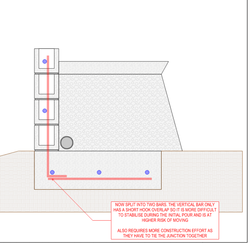

I commonly do it for retaining walls - it saves them a bunch of steel and makes it way easier to support all the bars
The horizontal legs support the vertical legs and vise versa, whereas using straight footing bars tied to a short-hooked vertical starter is a floppy system with way more tying required
Agreed with bugbus. Only the vertical part of the dowel would be in development (Ldh) so the long horizontal leg doesn't do anything for development. And yes, it's not fully developed, but it's not really possible to fully develop #5 bars in an 8" or 10" slab. This is going into the weeds a bit, but I had a debate with another engineer about dowel size. We never really resolved it. But the general idea is that if you're using a #5 instead of a #4, you won't get full development, but you can use the ACI 318 strength reduction (Lactual/Lrequired or something like that) allowed for partially developed bars, and the #5 will function the same way as a #4.

Agreed, that's one of the issues with the detail that I'm working with the original engineer to fix. I'm hired to do quality control and calculations.
I'm not following. Can you explain this again?

If this dowel is intended to work in shear for some sort of lateral load than the calculation should follow the shear friction provisions of ACI (if this is IBC design). You could intentionally roughen the top surface of the walls to get more capacity out of this joint.

Technically this reduction is not permitted for hooked bars.
ACI 318-14, 25.4.10.2 exception (b) triggers for dowel conditions as these are for shear friction transfer and need to develop Fy on both sides of the slip plane.
ACI 318-19, 25.4.10.2 amended exception (d) to include hooked reinforcement.

In that case, though, I don't think even #4 can be fully developed. I ran a quick calculation using 25.4.3.1 and I got 9.5" for 4000 psi concrete.

I'm not sure what you mean by "double-counting". It does perform 2 functions, if that's what you mean. the hook would theoretically develop sufficient tension capacity for the vertical leg, and the extension gives it sufficient development to resist the moment in the footing. I don't se it as being substantially different than a straight bar extending through a tension zone - there's tension force pulling both directions away from the middle.
In the case of your dowels, if the dowel is supposed to carry moment around the corner, the horizontal leg of the dowel has to have a lap length to the top horizontal bar past the point where both bars are needed to resist the negative moment in the slab.
Milkshake, I've quickly knocked together some sketches to show what I mean
In general terms, both are fine ways to build a foundation (though in the 2nd one my footing bar should probably have hooks)

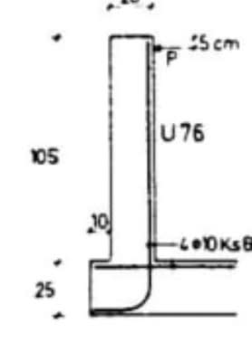

This is a bit off-topic and a somewhat controversial topic to discuss, but these joints are generally much stronger if you turn the cog back towards a slightly extended toe (image below). The two methods illustrated above can result in the cogs ripping out well before the wall or footing reaches its flexural capacity. Often that’s fine and these walls have plenty of capacity anyway; but not always.
@Bridgesmith I understand, thanks for the explanation. It's for diaphragm shear transfer, not moment. I prefer to keep this pinned, so maybe I'll shorten the bars to the ACI minimum. I'll keep it in mind for real moment connections.
@Greenalleycat Thanks for sketching it out! I get what you mean. And if the retaining wall is taller, that big piece can still function as a dowel.
