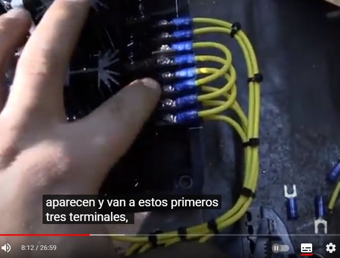

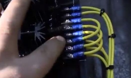

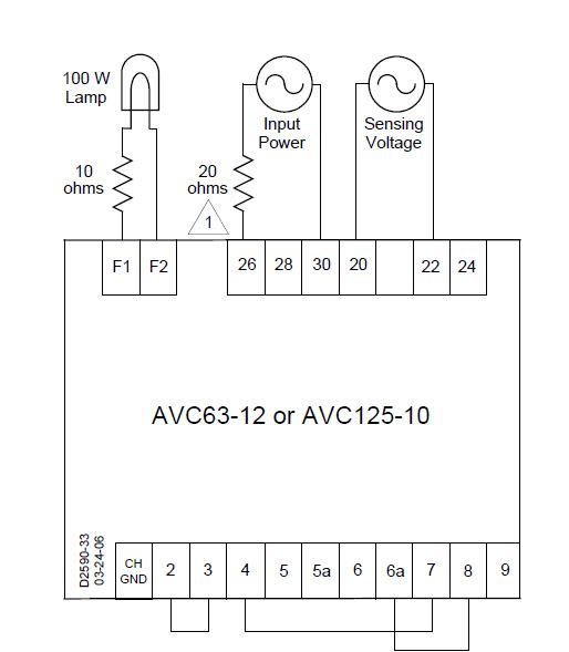

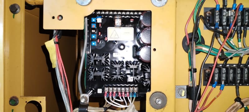

Hello everyone, I have a very serious problem after removing the avr cat sr4 (9Y8400) that generated very unstable voltage. I replaced it with the vr6, but this gave me a worse headache, it was installed in the SE way but when generating for 2 seconds the protection fuses opened, 12 amp, the configurations are fine in the wiring, but I do test tests on the output of the vr6 with bulb output between f1 and f2 and it shows 130VOL DC, with 90 vac external power input, it looks fine but when I place this avr vr6(a) the fuses in the generator. between F1 and F2, there is 4ohm. but vr6 manual pdf does not mention that feature to me. I request a lot of help please.

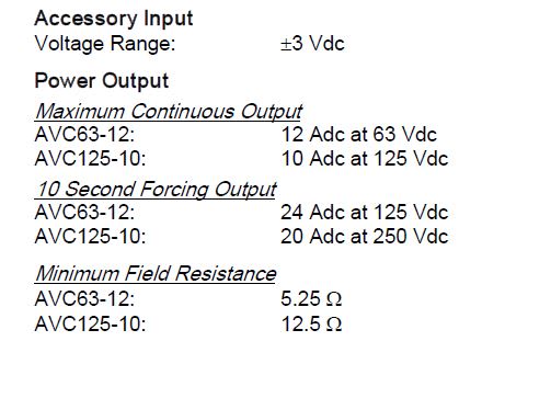

4 Ohms is in the normal range for exciter field resistance of an SR4.

EXITATRIS FIELD IS 4 OHM, here I leave you information about the original manual of the new vr6, without success.
The field f1 and f2 were tested with meguer and ok, tests were carried out on the diodes and ok. The generator is fine, but the vr6 test does not pass mounted on the generator. I will show you some photos of the VR6 wiring, how it was installed, for a few seconds it generates but it shorts out or the fuses open. Another data on terminal 22 rises 65 amps during those 2 to 5 seconds, but the panel voltage is 227 volts during that instant before the fuses open.
I tested the image in the diagram with 120 volts (the test passed)..The second image corresponds to AVR Basler specifications on ohm exitatris.... the color images are combinations that I also made for testing but installed in a generator, those images are identical tested connections found on the internet, maybe making those configurations The AVR opens the fuses.

Let's start simple. With the generator at standstill, power your AVR from an external source. If the AVR fuses blow up, your exciter field winding is gone.
