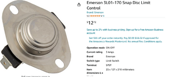

Respectfully and alternatively, could that be a Klixon type temperature sensor?
You are right, Sir! The symbol indicated suggests it could be temperature sensor (Thermistor with a contact output, I suppose).
Thanks for correcting me.
Possibly one of these.
Cut-In: 130 degree F; cut-out: 170 degree F
