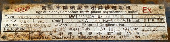

I am attaching motor nameplate (its an Cl2 compressor)
The running ampere on the meter (it varies with throughput) is now 320A
According to this post (https://www.eng-tips.com/threads/actual-work-380v-vs-460v.91809/post-344509) , total electric kW input will be
=1.732 x 320 Amp x 380 Volt x 1 kW / 1000 W = 210 kW
& if I multiple it by 24 hr I can get kWh
The problem is that nameplate shows a rated power of 185 kW however mine calculate answer is higher than this?

380V x 1.73 x .0.87 x 0.959 x 320A / 1000 = 148 kW Actual Mechanical Power Out
380V x 1.73 x .0.87 x 0.959 x 336.9A / 1000 = 185 kW Maximum Rated Mechanical Power Out
380V x 1.73 x .0.87 x 336.9A / 1000 = 193 kW Maximum Electrical Power In.

Output KW = √3 x Input voltage x Input current x power factor x efficiency = √3 x 0.38 x 336.9 x 0.87 x 0.959 = 185 KW
Input KW = Output KW / Efficiency = 185/0.959 = 192.9 KW
At 320 Amps, the current is at about 95.2%.
That does not imply 95.2% loading.
The efficiency typically increases as the load decreases and peaks at around 66% to 75% of full load.
If this alone is considered, the load may be greater than 95.2% at 320 Amps.
However that is not the only factor.
The Amps must be multiplied by the cosine of the angle of displacement between the voltage and the current.
This is given as cos(theta) = 0.87
Unfortunately the PF value is valid only at full load and decreases as the load decreases.
