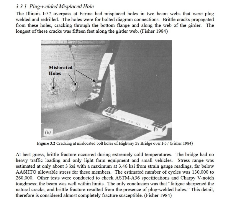

I'm replacing an existing diaphragm on a bridge, connecting to the existing connection plate on the girder. The iron workers drilled new holes in the connection plate to align with the new diaphragm holes, but one of the holes is too close to the existing hole to meet minimum bolt spacing requirements. They're asking if they can fill the old hole with a plug weld to satisfy the minimum spacing requirements. Does AASHTO or AISC address this at all? See picture below.
If the hole is empty, then you can use edge distance and not hole c/c provisions.
Thanks canwesteng. Unfortunately, AASHTO requires 2 bolt diameters clear space, which I definitely don't have here.
Huevo,
That's exactly what I'm looking for. You're a hero!
I believe the AASHTO clear distance requirements for bearing on the edge of the hole would apply only along the line of the force. In a typical configuration, the force in this case would be close to horizontal. You may not have to do anything with the extra hole.
That said, if it's the contractor's screw-up, and being fixed on their dime, I tend to follow the philosophy of making it as painful for them as you reasonably can, so they don't do it again.

On a bridge girder, nearly every detail and every connection is subject to fatigue, and oftentimes an open hole is better than welding to plug it.
I second BridgeSmith's opinion. A plug weld is not the best detail to use in this situation.
Could you drill through and combine those two bolt holes into a slotted bolt hole?
Impacts on the design would need to be considered though.
Link
