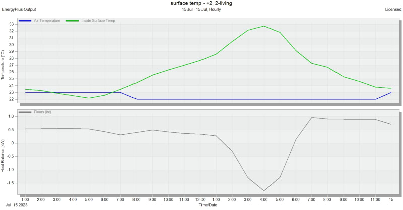

I have modeled a 8-storey building in designbuilder software. there is a the problem in its cooling load report; The report indicates heat transfer in middle floors which are located between 2 conditioned spaces. I made the software to ignore thermal mass effect. Is it a bug in the software?
this is a screenshot of its report in summer season

I guess surface convection cause this negative load but I dont get the physics behind its calculation .
This is the heat gain graph through floor for summer design day. The point is that, air temperature is less than surface temperature, so the surface convective heat gain must be positive!
It looks like you are reducing air temperature (blue line) at 7:00 and raising it at 22:00?
Could the inside surface temperature be exterior wall warming up due to sunshine?
No, because it is floor not a wall.
